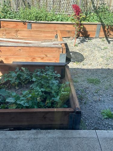

I have two garden beds that I want to get rid of. I used Galvanised Steel retaining wall posts on the corners and are deep inside with quickset cement. I have since filled the backyard and getting inside to break the concrete around the posts will be a lot of work, so I am planning to just dig smaller holes around the posts and cut them instead. Planning to put artificial turf on top. I probably shouldn't have used retaining wall posts for garden beds to start with.
What kind of tools I will need to cut them? (I couldn't find the exact product they are similar to this: https://www.bunnings.com.au/jack-50-x-450mm-galvanised-steel-retain-it-corner-post-upright-sleeper_p...)
Thanks in advance.

In order to cut the steel posts, I suggest using an Angle Grinder in combination with a Steel Cutting Disc. If you decide to get this tool, I suggest speaking to the tool specialist at the store to make sure that the cutting disc you purchase is compatible with the angle grinder.
Another method is to use a Steel Hacksaw, it may take more time to cut the steel, but it is just as effective.
Please remember to wear personal protection such as gloves, goggles and a mask when working on your project.
Thanks Eric. I will get an angle grinder with a steel cutting disk as you suggested. Thanks again.
