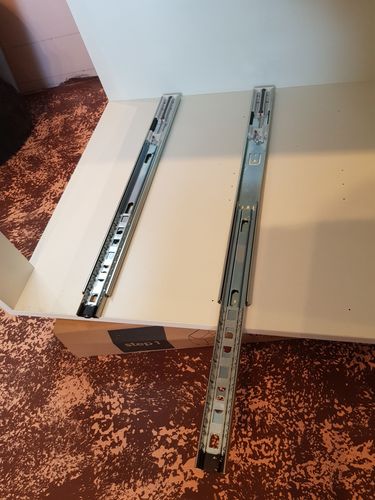

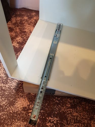

The holes in the runners and the holes in the cabinet do not align.
Do I use the pre drilled home nearest the front of the cabinet to locate the runner and drill new holes for the rest of the runner?
This would mean the runner protrudes beyond the edge of the cabinet 4mm, with a 10mm gap between the end of the runner and the back of the cabinet.
Thanks in advance 😁
Hello @margoburl
It would be best to have the runner towards the back of the cabinet rather having it protrude at the front. I propose using the pre-drilled spot in the middle. However, the goal is to make sure that the runner does not go past the side of the cabinet.
When you find that middle spot or the spot that gives you good balance that would be where you need to put the first screw in. Please make sure to use a spirit level to make sure that the drawer runner is level and not leaning up or down. Mark its position well with a pencil and put new screws at the front and back of the runner.
Thanks Eric
