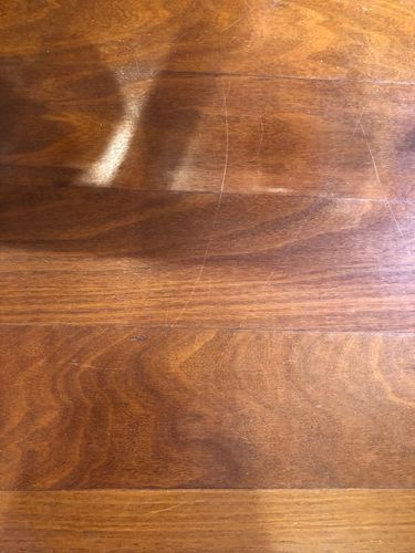

i have very light scratches on my polyurethane floorboards.
someone suggested butter.
I don’t know the technical name.
also do crayons work.

I suggest using Waxstix to cover up the scratches on your floor. Using butter would only contaminate the interior of the wood causing it to get stained. Crayons will work but will not last as long as the Waxstix which are designed to repair scratches on wooden panels.

An old trick for timber scratches was to make a 4 tea bag pot of tea or in a cup and the tanins or tea stain would be wiped onto the floor allowing the scratches to gain darkness to match the floor/ furniture colour weather this works on Polyurethane scratches and the under layer maybe you can try it and tell us. An old take on a modern product.
Slowly use a cloth or cotton ball soaked in tea to build up colour in the stain to match. try not over staining floor scratches as you will have dark lines instead of white. Maybe let the stain dry when you are close and let it dry as when wet the stain looks darker keep the tea stain in a cup for the short term cold tea works the same.
@EricL solution of a wax stick can then be applied in a clear as this helps fill the scratch micro void into a stained and filled micro scratch.

i will try that. I did use a tea bag at one stage but it didn’t seem to make any difference.
Think I need to slowly build up.

If the teabag stage one fails then the plastic isnt taking the light staining. So what do we try next? Maybye clear wax alone will obscure the scratches using its light index to bend Or a brown tinted wax?
I have updated my mental records tea dosnt work on plastics, thank you so much for tryng. Respect.
