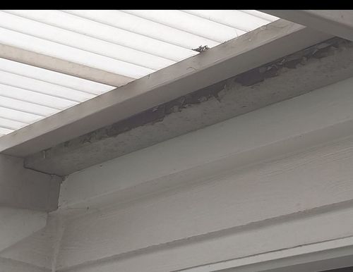

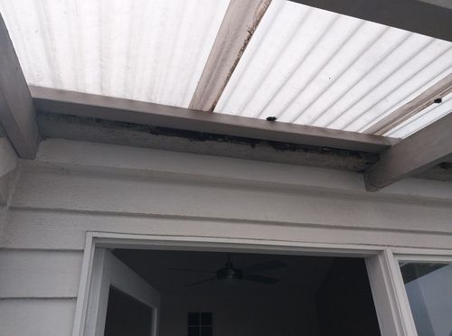

we have this gutter that is rusting and peeling. It's leaking.
Trouble is as you can see it's under the polycarbonate roof.
How can we fix this?
Also we tried putting some tape over it but that hasn't stopped the leak.
Replacing the gutter isn't straightforward as access is not easy as it's a double storeyed house.
Any thought?

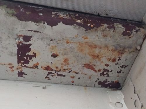

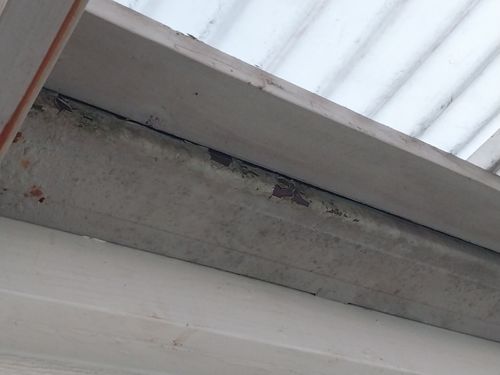

zoomed in photos..
Water is travelling down the beam too
If they didn't seal the leak, then the water is somehow bypassing them @nishtha. You can try again with the method I've explained above, or you might like to remove the tape and show us the area where it is leaking so we have a better idea of methods that could work.
I just got up the ladder and felt it.. the tape definitely hasn't been pressed hard.
This was done by my hubby so I don't know if he didn't press it hard to begin with or it's come loose over the couple of months it's been there.

It depends on how degraded the metal is, @nishtha. I can see from the image that it isn't adhered to well, as you've discovered. I don't think it's going to do additional damage if removed. He might have applied it over loose paint, which has since delaminated and allowed the tape to come off, or he might have applied it cold and found it hard to stick. I'd remove it, clean the area, and re-apply the tape warm.
If it bonds well, you might get five years out of it, or you could need to replace it periodically.

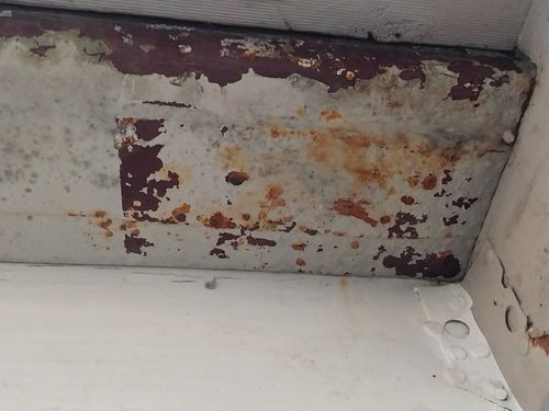

Do you think we need to do anything to the rust prior to applying the tape?
am also at a loss to understand why is the left side so much worse than the right side?
left side
right side
