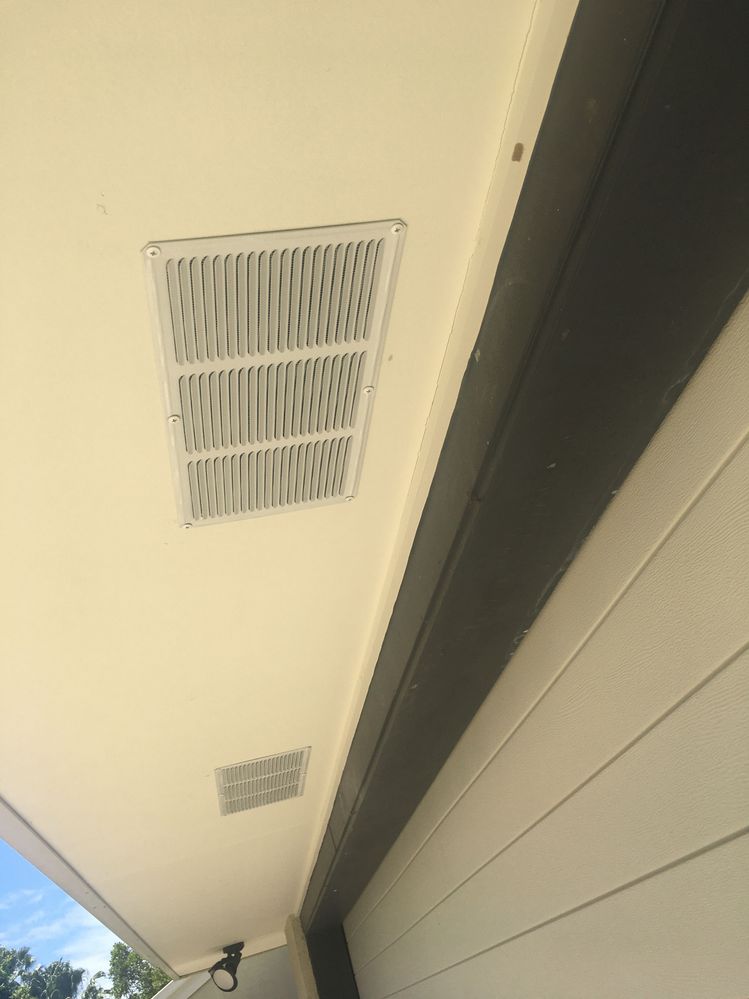

A friend lent me his Worx Compact Circular Saw (I think Ozito does one similar) with a diamond blade that he used to use for cutting out old tile grout. It has a laser guide so it was easy to get a good straight cut. The hardest part is holding it up above your head to push it onto the soffit. An angle grinder would work too but maybe less accurate?
I screwed the vent grills straight into the FC sheet with the Zenith 8G white headed needle-point screws. I'm pleased with the result and have included a photo.
Thanks for your help. Happy DIYing, Dave
