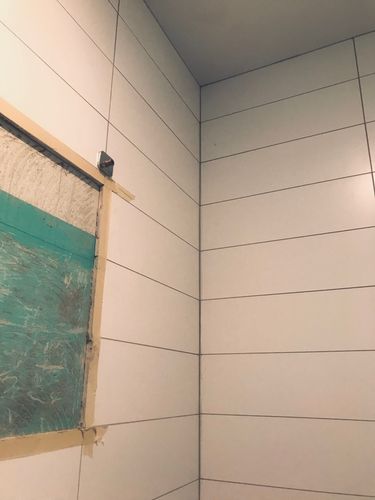

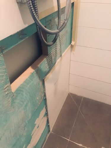

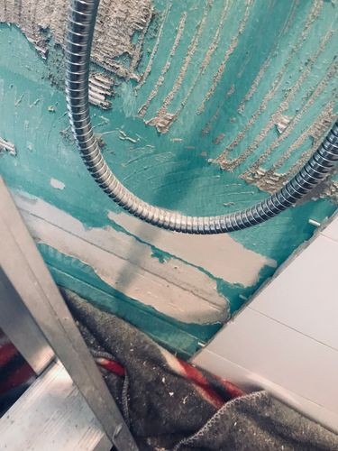

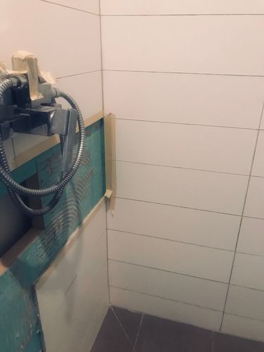

Hi my plumber remove few part of my bathroom tile to find water leak but can’t find any water leak. He pull out the tile and damage the waterproofing membrane. Please advice how do I repair the waterproofing membrane and put up the tile. Thanks

Hi thanks for your reply. Long story short, he won’t do anything about it. Most tiler are busy, find one can do it but won’t give guarantees on the job unless I redo the whole shower room. I can’t afford to do the whole bathroom. I have remove the broken tile by myself without damage the good tile. I need guardian to do what I can to fix my shower room. Please advice . Thanks

The issue is that a shower membrane is a continuous coating applied over the base of your shower and then up the walls. Hopefully, you shouldn't need to do the whole bathroom if your shower has a hob, but I'd suggest most waterproofers will want to redo at least the shower recess to be confident in warranting their work. Simply patching this one area is not a great solution. At a minimum, I suspect you'll need to remove all the floor tiles and lower wall tiles and redo the membrane.

Do you have any more photos showing the whole shower from further away? Dependent on whether your tiles extend a long way beyond the shower area will affect any remedial options but generally Mitchell is correct that you would have to keep the membrane continuous and therefore it is necessary for the whole shower area as a minimum to be waterproofed and tiled.

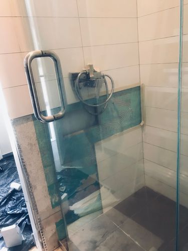

Do you have a photo that shows the entire shower to the very edges. Including a door, vanity or anything like that? I’m still unsure as to whether it is just your shower that is tiled or the entire room. cheers
Hi attached photos. Looking forward to hearing from you .

Let me tag @Vis-á-vis to make them aware that you've posted photo updates. Looking at your earlier posts, If it is not a plumbing leak, I suspect that the leak could possibly be coming from your roof and is travelling down your bathroom wall. I'm afraid no repair or patch is recommended until you find the source of the leak. Repairing it now will only aggravate the situation and you will get the same kind of damage again.

It is always difficult to give someone advice or a diagnosis without hands and eyes on inspection. I do a lot of remedial waterproofing construction and try not to give advice without an inspection. That said a few things do stick out with your shower.
The construction is very unusual here in Australia, for example, foam panel walls are not something you see very often. Where are you located?
Some things you should consider;

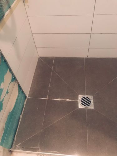

- You definitely have water under your shower floor tile. There is fairly significant efflorescence in your grout joins.
- The waterproofing on the shower wall falls short of the hook for the shower rose (would not meet the Australian standard)
- Outside of the shower where you have removed a skirting tile there is no waterproofing, the Australian standard states that you should come at least 150mm up the wall.
- It seems you have a step up to the shower. This could be a pre-formed base or a screed inside a water-stop. It does not appear that your wall waterproofing runs continuously across the wall to floor junction and on to the shower floor
All-in-all you are probably best to consider taking the entire shower out and starting again but not without a professional opinion after an eyes on inspection.

We do use foam panels for walls here in Oz but only for external walls that will be clad or rendered. There are other types of panel designed for showers such as Kerdiboard.
I'm not saying that water under your tile is the cause of the door not closing although it could be. If you look at the join between two of your floor tiles there is a clear case of efflorescence - water is under your tile and as it evaporates through the surface it leaves salt-like deposits on the surface. Grout is porous and small amounts of water underneath are fine and that is why you have a waterproof membrane that will take the water to your leak control flange without further damage.

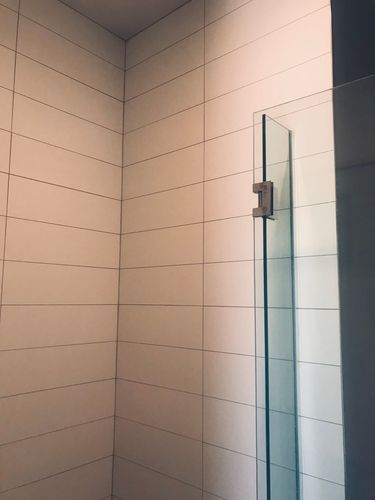

Before I really believe I can do it myself now I am not so sure. You guys are right. But it is hard to find someone to help fix my problem. The tiler just do tile then I need a builder or handyman to fix the wall and the shower door. I don’t know who I can trust they all seem guessing. One of the builder quote 15-16k. This door photo I used for found someone to come to fix it then he said not the door problem. I do ask 5 to 6 professional come to look they all think have leak but after all the mess there can’t find water damage not even water mark. I really don’t understand. May be I remove the floor tile take a look ? Most tiler not available. That’s another problem

Hi EricL, I don’t think there have leak because there no water mark anywhere. All start because the door not close probably. As you can see the photo the door bottom and the top out of alignment. As I trust the professional plumber , builder and the insurance inspector they are all wrong. They just like Oops it is strange may be your house poor workmanship then leave me to tidy
