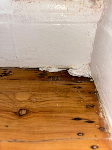

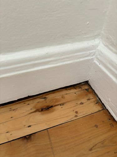

I’ve got gaps between the floor and skirting board too but I’m mainly concerned that dust and debris and also cockroaches come in and out from there. Would you recommend the same products to block the gaps up and prevent dust and cockroaches from coming in and out? Pics show gaps that i temporarily tried to fill with paper towel the other night when a cockroach came out from it, and then also an unblocked gap for reference. I’d say the majority of the property has a gap between skirting and floor with only a few places where the gap is very small or there is no gap at all. I am renting.
Welcome to the Bunnings Workshop community @rec. It's great to have you join us, and many thanks for your question about filling gaps in skirting boards.It's always best to request permission from the landlord before performing any work on the property. I think they'd be quite happy for you to fill the gaps to prevent insects from entering the home. I suggest using Selleys 475g No More Gaps Interior Multipurpose Gap Filler and taping up the skirting and the floorboards before applying the filler. Here's a helpful step-by-step guide: How to silicone a gap.
For the larger gap on the last image, you might like to first insert some backing rod to prevent excessive filler from being used.Please let me know if you have any questions.Mitchell
