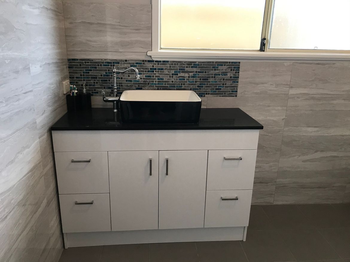

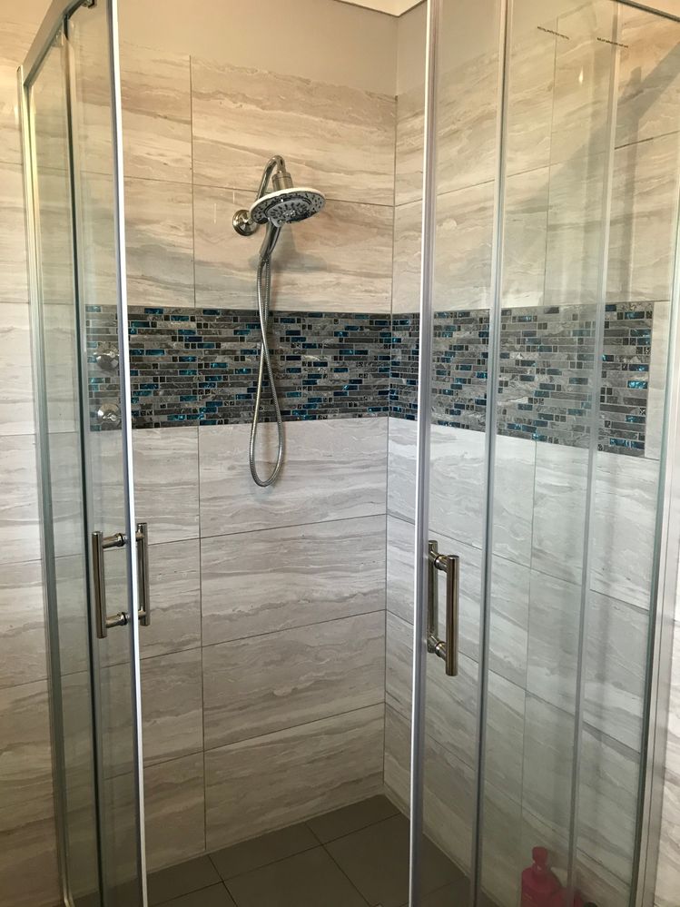

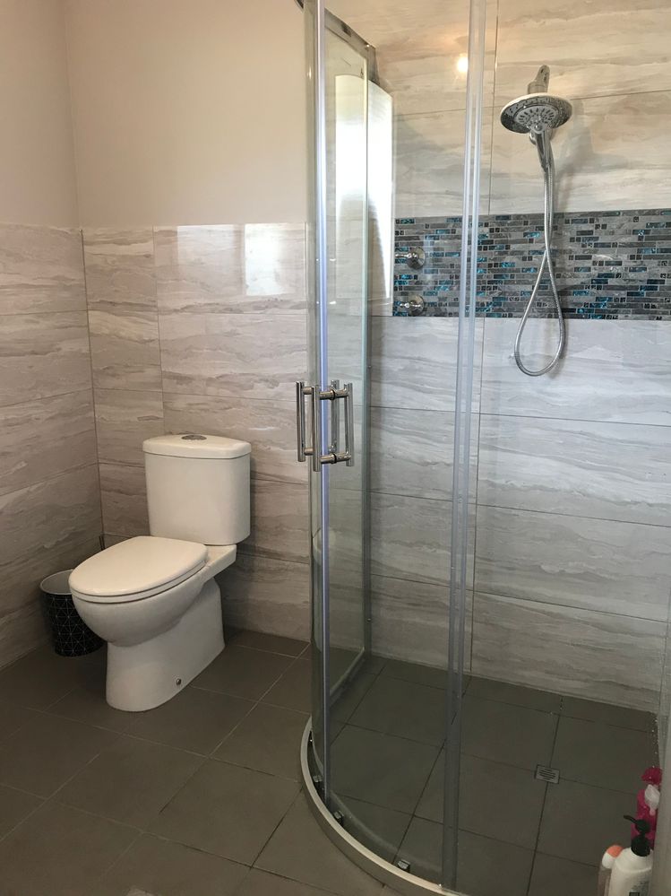

Completely gutted the entire en-suite bathroom, then retiled and added new shower, toilet and vanity. Absolutely stoked with the end result.
New vanityThe hard yards....Stripped bare.New curved shower screen.

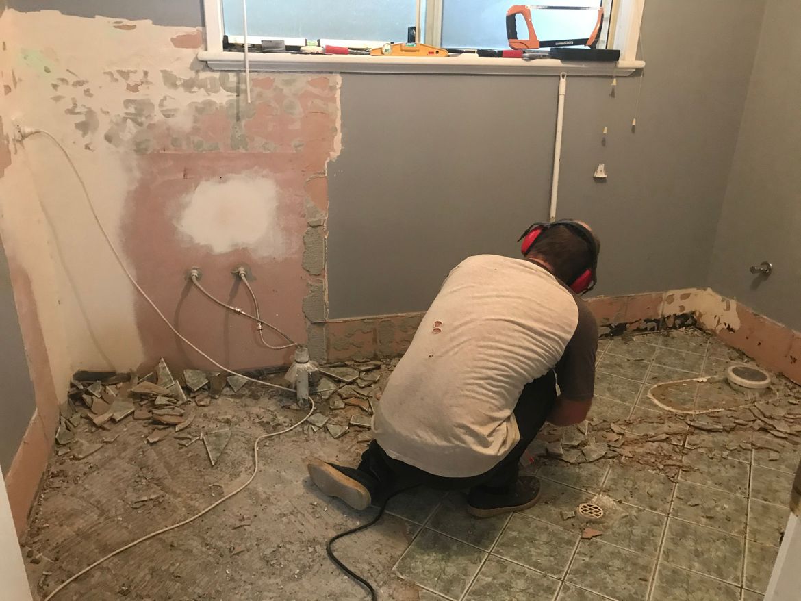

The first photo - were those old tiles hard to lift? What tool are you using there?

I bought an Ozito hammer drill/jack hammer for around $100 and they came up relatively easy.

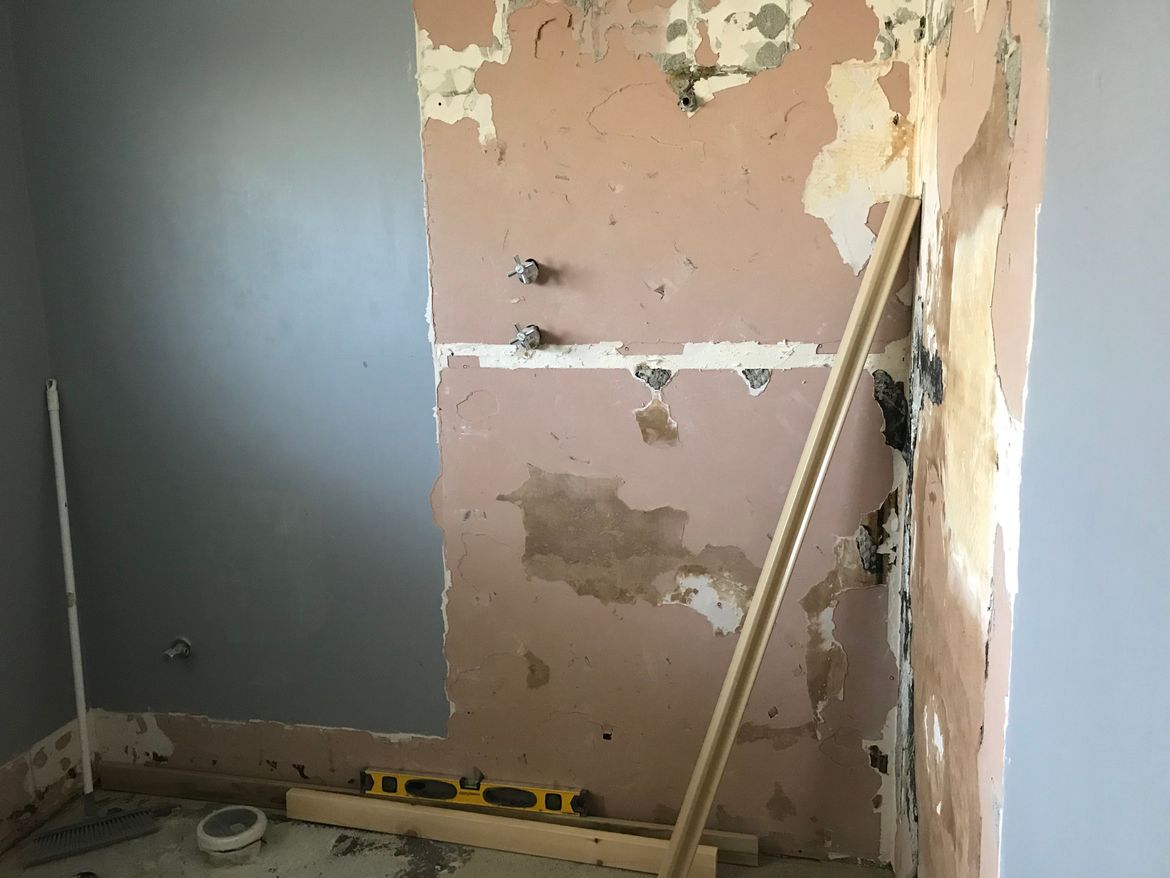

The hardest part was stripping the entire room and removing old tiles, toilet, shower screen and vanity. The floor needed quite a bit of levelling to get the right fall for floor and shower drains which we achieved by adding a screed of cement based tile glue. The same could be achieved using a sand and cement mix.
