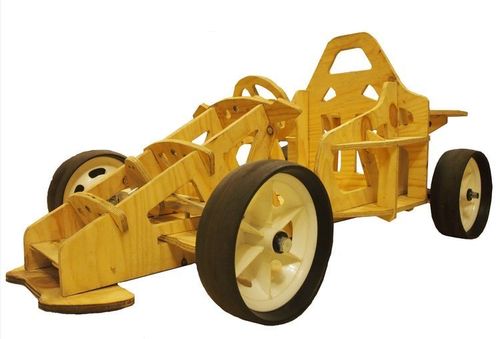

Billy cart made for my son made with plywood and fixed with interlocking joints

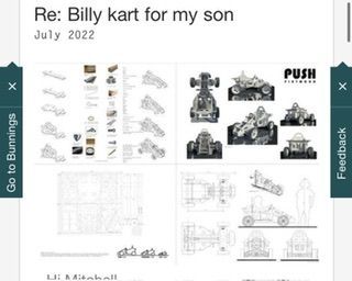

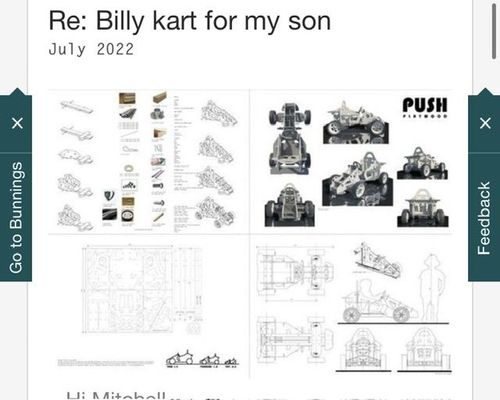

Hi Mitchell,
I used Revit, interlocking plywood panels with glued timber dowels for the main body, see attached instructions which Anyonw is welcome to use for free, made from 12mm plywood single sheet 2400x1200mm
