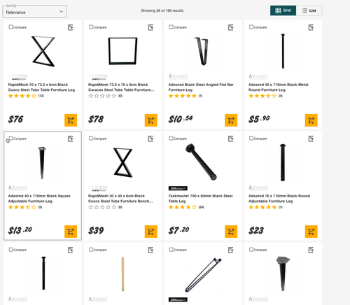

The next step is choosing the legs, which you can also select based on your favour and requirement

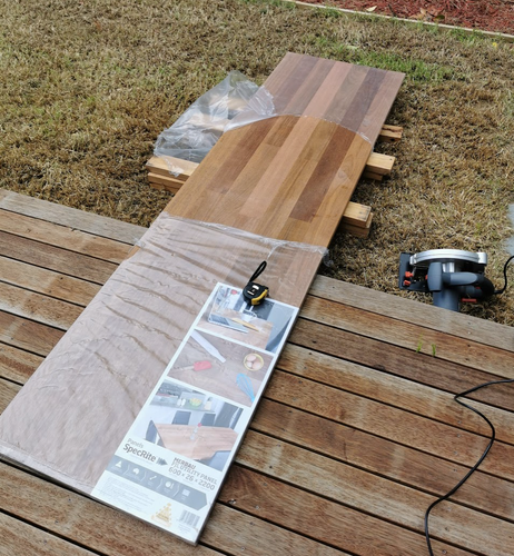

2. For me since I need 2 desks, I have to cut the board in half, I used a circular saw and did the job.

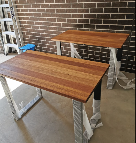

8. After the timber is fully prepared, pun them upside down on the ground with the protection and you can install the legs! (or you can do this step before applying the varnish/paint/oil)

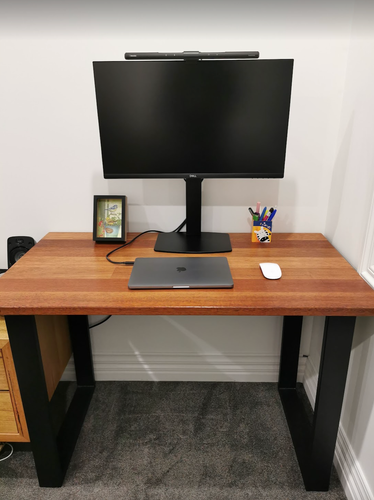

9. Job done and enjoy the new table!🎉
