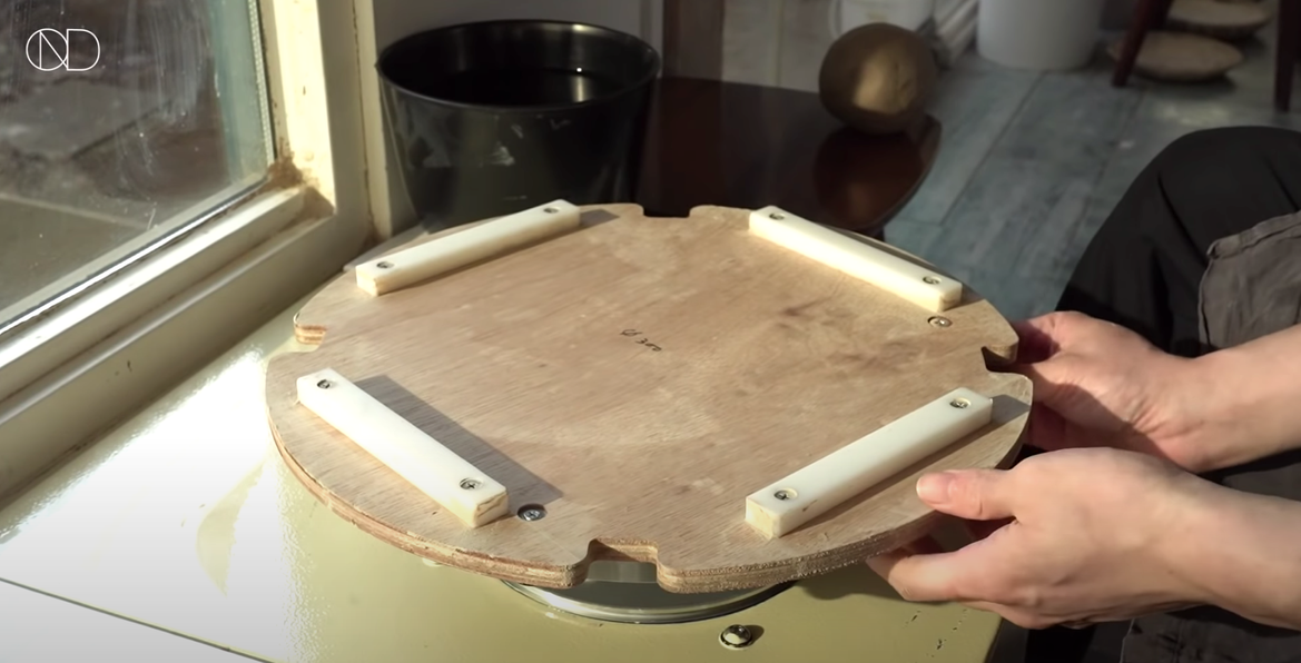

Hi all,
I'm looking to make an accessory for my pottery wheel similar to these pictures, I wonder what the best way to approach it would be, and what the round fasteners used to tighten are called?

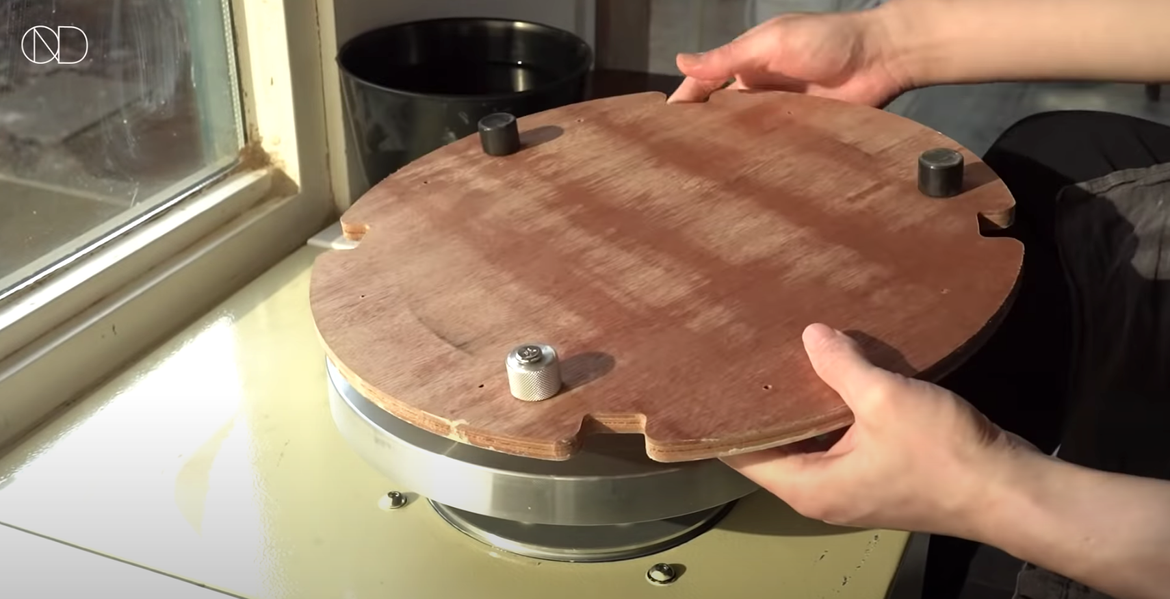

If you look closely at the first picture you posted you'll notice that the bat pins they used are two rubber pieces and one in steel. These are possibly custom-made or available only at specialty pottery shops. However, you can duplicate the function by using Surface Gard 25mm Brown Round Screw-In in combination with a wing nut and a machine threaded screw with a flat head.
You'll need to double up the surface guard so that it fits snugly to your current pottery wheel. The tightening action will happen when the wing nuts begin to compress the rubber. This in turn will lock the bat in place to your pottery wheel. The bat wheel has to be totally centred on your current pottery wheel to prevent it from vibrating.
You'll see in the second picture they've installed guides on the outside of the circle. These guides actually hold a square piece in the middle where you throw your clay onto. The guides can be made of the same material such as plywood, but if you can get your hands on some very thick plastic that will work as well.
Here is a handy step-by-step guide to cutting a circle in timber: Circle cutting template, without drilling a pivoting point for a plunge router/trimmer by @JoeAzza
