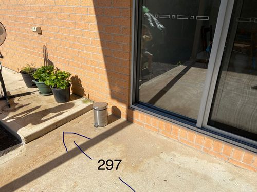

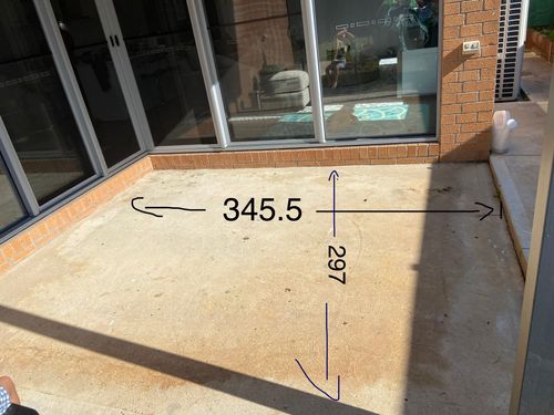

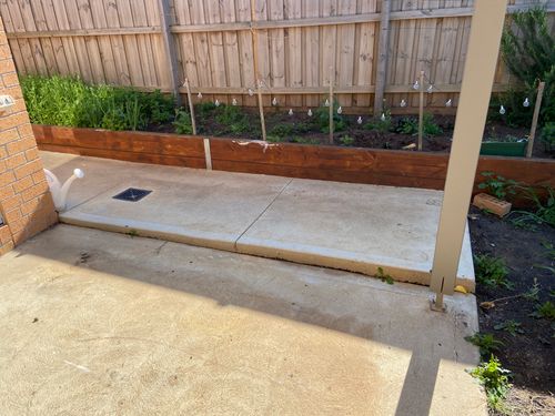

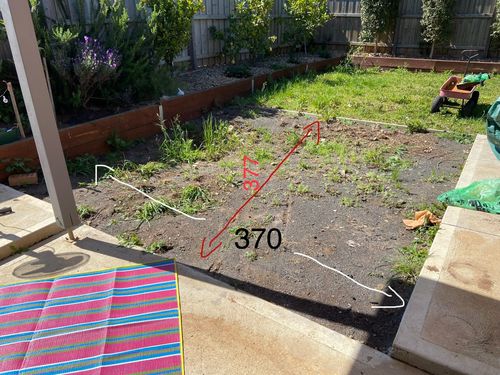

Good morning Eric , thanks for replying me back , as you recommend i taken pics and dimensions as well ,
Dimensions are in CMs please have look and advise accordingly , that will be big help , please guide me as i am getting $200 per square quote and its about 23square meter area , please advise approximately money i can save if i will do it myself .

Thank you very much for posting those photos of your proposed decking area. I suggest having a look at this discussion - Low-level composite deck over concrete and soil by @oninpena. This is a very good example of building a decking frame that goes over both concrete and soil. They used 90x45 H3 framing timber for their deck framing. With the space available this might be suitable for your plans.
I recommend sketching out your decking frame on paper so that you'll have an idea of how much material you'll need to assemble your deck. I suggest having a look at the deck-building guides I suggested to help you plan your deck. Building the deck yourself will save you from having to pay for labour.
