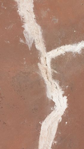

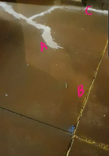

A (Surface) & C (Edge connected to Brick Tiles) had cracks.
Gripset Betta Concrete Crack Filler and Selleys Spark Filla Heavy Duty were attempted. But the results (especially on A) hasn't been too satisfactory.
Here's a closed up on A after only 3 weeks under the hot Sun, with only some light rains in between. Weather were dried the few days before & after double application. perhaps due to incorrect application/movement of vehicle before they were fully cured, cracks formed not long after.

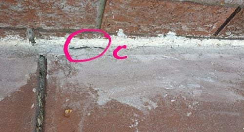

On C (Edge of joint to Brick wall/Tiles where kids can walk/jumping on top), new cracks appear too in less than 4 weeks. Could be resulted from combination of high UV/ vehicle movement, is our guess, or wrong choice/method of application.

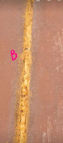

B (Expansion joints)were crowded with weeds & soils. After they were removed, the expansion/contraction joints (B) gaps were wide, ranging between 5mm to 20mm wide, and up to 5mm to 20mm deep. Parfix Triple expanding foam filler were applied once to try fill up the joints. The results looked smooth & joints completely filled, before the overflow foam were cut.
Here's a closed up of the expansion joints (B) foam filling after the excess/overflow foams were cut, to level up with the concrete surface.
As is, the joints (just like the entire driveway, before garage entrance) look ugly, and there're tiny holes along the joint lines, allowing water & sands to going under. And along those sections where not enough depth of soils were removed,some of the foams pieces had dried up & got pushed off by soils underneath, with pressure from vehicle.
