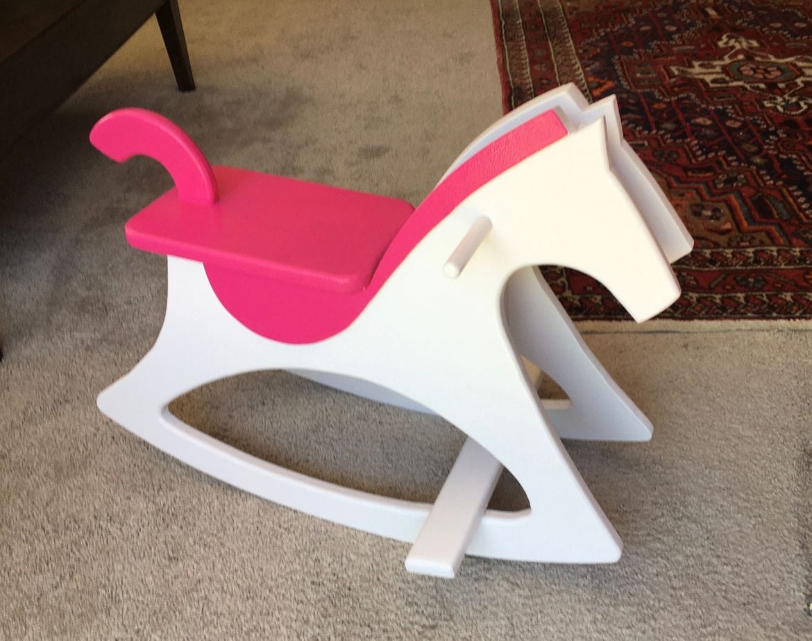

all mdf for inside of treated ply for out side . This one mad from scraps of 18mm mdf
plans available off the internet message me and I will send you links
can be made from two quarter sheets, easy to pop in car, I used some 16mm dowel for the handles available from Bunnings. I got a 900mm of dowel smallest length and may knowck up another when I get time.
this one for a girl is painted with BP undercoat sealer and topcoat of dulux aquanamel satin. The darker pink is a can of rustoleum to get a bright pink
The mare is being ridden as I write, Zara 3 is rocking it!
tools used … a Ryobi jigsaw, a sander, a Ryobi drill and screws and exterior PVA glue. I used 45mm stainless screws and bogged the holes with builders bog from aisle 16
