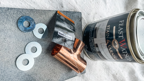

Materials

I opted for a 20mm Copper tee and 19mm dowel. If you have a smaller, more delicate project you may prefer a smaller dowel and tee.

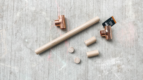

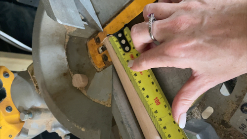

Step Three Cut the Dowell
Once I had measure the distance between my screw holes on the cabinet I had the length for the middle bar. There’s a little back and forth as you need to be precise, unless you want to redrill the holes. I had miscalculated initially as I didn’t account for the lip inside the copper tee so the dowel stops short of the centre.
I decided to cut 40mm lengths for the two ends of the long pull and for the short pull. I kept these lengths the same for consistency.
TIP: Measure twice and always double check. Once I had glued one side I double checked the measurements and held the pull against the cabinet so could see I had miscalculated.

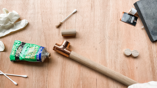

Step Five: Assemble the pull
I applied liquid nails to the interior of the copper tee and pushed the long dowel as far as it would go. I then double checked my measurement and applied liquid nails to a second copper tee and pushed the dowel through. I was careful to ensure the copper tees lined up and the manufacturers stamp was on the outside of the tee. I then applied liquid nails to the copper tees and pushed in the 40mm dowel on either side.
I plan to recoat the dowel and to sand the ends so they’re smooth ( I haven’t quite decided if I will round them or leave them straight). I’ll decide than once the cabinet is finished so I can see how it all looks together.

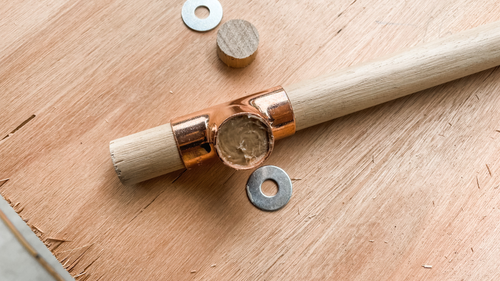

Step Six: Base of the pull
The bottom of the tee will secure the pull to the cabinet.Â
I filled the open tee with liquid nails and pushed in my pre cut 10mm of the dowel. Once inserted I applied liquid nail over the exposed section of the wood and placed a washer on top. Repeat this for each tee.

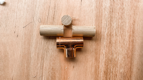

Step Seven: Assemble single pulls
I followed the same process as with the larger pull. I cut 2 pieces of dowel at 40mm and once I had applied the liquid nails I pushed one into each side. I then applied liquid nails to the bottom of the tee and pushed in 10mm dowel and added a washer.
