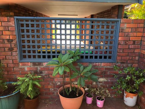

The lattice and section of wall beneath it (pictured) has just been removed for bobcat access for a landscaping project. Chasing some inspiration of what to do when we built something back in its place.
Note: the wall backs onto the carport.

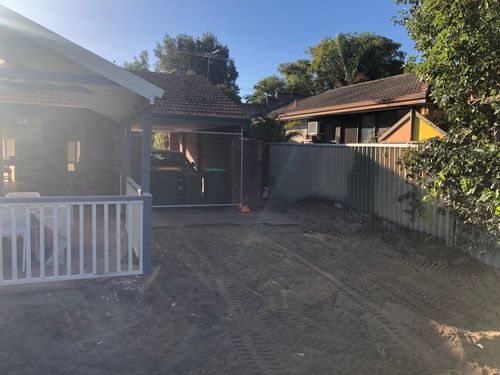

Could I please trouble you for some more pictures from further away so we can better understand the context of where this wall is in relation to the rest of your backyard. It might help community members provide more helpful recommendations in keeping with your garden.

Hi @frasesmith ,
That is a cute little area. It would be great to have a bit more information so we can make some great suggestions for you. What is the width between the remaining brick sides and the height of the brick wall and height to the eaves of the carport? Do you want total privacy or the way the lattice is was good to allow for airflow? Do you need security?
As @EricL suggested, a trellis for a climbing plant is a great idea and can bring lush greenery and colour to the space. Something like a jasmine can bring fragrance too. But I'm not sure it will look nice from the shady carport side unless it was against a fence and the sun shone onto it. The vertical garden are also a great idea.
The matrix panels are a great alternative - check the height and width will work for the space. There is a great variety of styles. Be led by the architecture of your home to choose the best one and make sure the colouring works well with your bricks.
You could also try the panels https://www.bunnings.com.au/protector-aluminium-900-x-1800mm-satin-black-oriental-deco-screen-panel_p3041170
There are really creative modern barriers that could be done using Sandleford posts https://www.bunnings.com.au/sandleford-1-7m-terrain-feature-fencing-upright_p0330256 They come in various colourbond colours and timber looks.
Repotting those cute pot plants into complementary style pots and colours will make the area great again.
I hope that helps you. Belinda
Hi Jason, here’s some photos of where the wall is located in regards to the rest of the yard.
Hi Belinda,
Thanks a lot for your suggestions. Rough measurements between the pillars is 2100mm, height of the pillars is 1800mm and height of the eaves is 2100m.
We don’t need total security/privacy in this section as we will be putting a door on the carport soon as well.
Thanks Eric! Some great suggestions coming through I think I like the idea of trellis with climbing plants or the matrix screens the most so far.
Hi @frasesmith
Thank you for the extra photos. This is a wonderful opportunity for you to revamp your garden! Do you have a plan already in place? My number one suggestion is to make sure that the ground soil has a fall so that water does not pool in the middle of your new garden. It's also essential that you provide drainage for excess rainwater in your garden.
Any details you can share about your garden revamp would be very much appreciated.
That's a good size to suit a range of screen sizes. Now you just need to choose a style that you like.
Either off-white or surfmist to match the white patio, or charcoal to match the windows/gutters.
Straight slats might match the patio most https://www.bunnings.com.au/matrix-1810-x-905mm-slat-screen-panel-with-frame_p0131472
Or a decorative pattern if you like that.
Check the framing and ground support system too. Most panels are 900-915 wide, so you will fit only 2 panels plus the posts. Check how the left over space might be filled.
