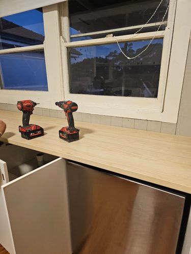

Hello - just recently installed a cement fiber sheet (https://www.bunnings.com.au/james-hardie-2700-x-1200-x-7-5mm-3-24m-hardiegroove-lining_p0712677) in my laundry, on the wall behind my sink and wall behind the washer and dryer.
I wanted to know the best way to paint cement fiber to provide protection from water/condensation and dirt?
Which paint and primer would work best?
(Sink will be installed where the drill and impact are located on the counter top)
Thanks
