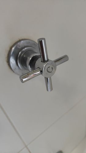

How do I remove these taps? Thanks
Welcome to the Bunnings Workshop community @Wilco1973. It's brilliant to have you join us, and many thanks for your question about removing a tap handle.
Behind the tap handle, where the spindle attaches, there will be two slots that should correspond with the tool available in this kit. This nut needs to be undone to release the tap handle. You'll then be able to undo the flange and access the tap spindle for removal. Have a look at this discussion on How do I remove these tap handles, as it has pictures of the nut you are trying to access.
Please let me know how you go and if you have any questions.
