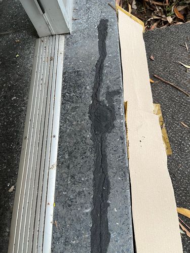

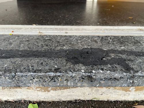

I have finally got to tackle this task; however, it looks very unevenly finished. How can I smooth out the surface? Sandpaper?
And how I can store the rest of the sealant without it drying out?What other ways/repairs can I use the sealant for? Could I fill up small holes in driveway asphalt?
BeforeAfterVery uneven finish
In order to preserve the remaining sealant, I suggest removing the nozzle and covering the top of the bottle with plastic cling wrap twice and then re-attaching the nozzle back on. Place the sealant in a cool dry place where it is not exposed to ambient heat.
If you find that the surface of the sealer is too rough, I suggest using a flat stone or brick and running it over the surface to reduce its roughness.
In regards to using it on your asphalt driveway, I suggest testing one hole first to see if it will adhere to the surface. Keep in mind that it might be necessary to do several applications as the filler might settle.
