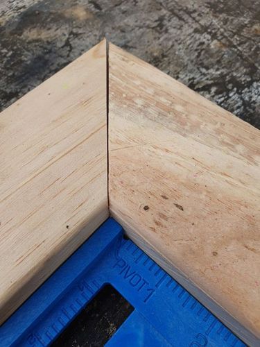

Deliberately made imperfect mitre to begin with...(but maintaining 90 degrees).

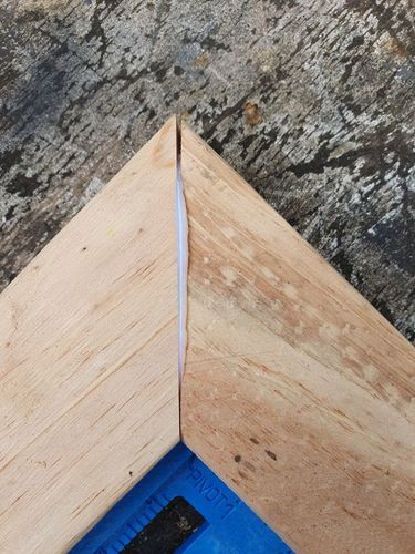

Glued - whilst still maintaining 90 degrees...

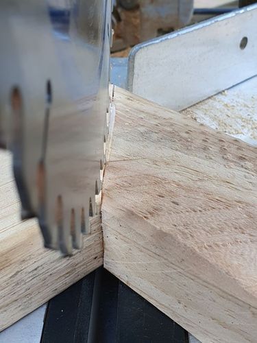

Yes...once the glue dries hard...you could cut again thru the centre of the poor joint but only if you left enough
wood at the start. My work was to make one long plank from pieces. Using metal plates on the back to strengthen the result. I was not making a corner joint. Also I find the biscuit joiner way not to be helpful and the biscuits are a sloppy fit, allowing movement and a fail.

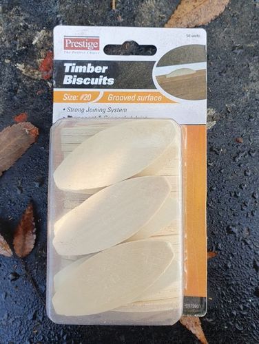

"biscuits are a sloppy fit"
Until recently I never had a problem with biscuits (wood variety). I sourced them from my neighbour who purchased them from the US and they were soaked in water for 30 minutes prior to inserting. Very tight fit.
Then I bought these from Bunnings on a clearance trolley. Never again. What brand are you using?
Far too loose.

Thank you for that tip. Soak to swell. I see biscuits are cheap if bought by the thousand!
