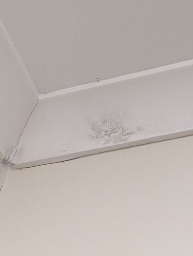

this has appeared overnight above the tiles in my shower (or I hadn't noticed it). Does it look like mould? We have had non stop rain for two days . How do I know if it is and what so I do to treat it ?
Yes, it looks like mould to me @firsthome2022 and is certainly not unusual in a moist and often unventilated area like a bathroom.

Hi @firsthome2022
Looking at the photo you posted, it appears to be mould. This often occurs inside the shower area when it does not have enough air circulation. The heat from the shower combined with the trapped moisture make the perfect environment for mould to grow in. If the shower area has no exhaust fan plus the window and door are always kept closed this will accelerate the growth of mould in the shower room.

Thanks ! I just put my hand in the wall where the mould is and it's very soggy and easily indented. I'm guessing that's not good. Should I get that inspected in case there's significant damage behind or just fix the mould ?
Hello @firsthome2022
I suspect that there might be a leak behind your wall. Surface mould is usually easy to remove and can be scrubbed off. But if the surface of your wall is soft and spongy something has made it very wet from the other side. At this point in time, I suggest getting it inspected by a tradesperson. They might need to remove your plaster board wall so that they can see if there are any leaks in your plumbing.
I also suggest inspecting the other side of the wall and see if any water damage has affected that side as well. While you are inspecting that area keep an eye on your flooring and see if the water has travelled into it.
