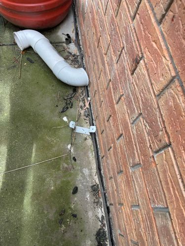

Hi everyone,
our house is 15 years old and there is a gap between the house and concrete path. How to fill the gap to prevent water damage the foundation? Thank you so much.
Welcome to the Bunnings Workshop community @jenniferji. It's brilliant to have you join us, and many thanks for your question about filling gaps.That's an expansion gap between your house slab and the pathway. It's not a seal that prevents water from entering and is there to isolate the pathway and prevent cracking. However, the gap has widened, and the expansion gap is not filling the area. For aesthetic reasons, you could fill the gap with Sikaflex 11FC, but there's not a great deal of concern about water entering and damaging your slab. There are plenty of other areas around the home where sub-surface water will reach your slab.
I'd recommend cleaning out the expansion joint and caulking the Sika product down behind it until it fills the area. You can then run a gloved finger over it to smooth off the surface.Please let me know if you have any questions.Mitchell

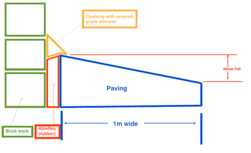

i have another DIY project. I want to put the caulk between the concrete pave and whole house above ableflex like the 2nd photo. Which product should I use 11FC or 11FC plus polyurethane adhesive sealant or other products? Also could I also have some tips please? Do I need to clean before I apply the silicone? Thank you in advance

It's great to see you're getting around to this project and the drawing you've provided is spot on.
Since the time of your original post, I have done a similar project in my shed. You can see it here - How to fill a joint in a concrete slab?
You'll see that step one is cleaning up the crack, which is essential to getting a quality seal. I used a screwdriver to agitate any dirt that was in the crack and a Makita 18V Blower to blow it out. If you don't have a blower, you can use a pressure washer, or even a garden hose and a brush to clean the crack. You're aiming to create enough space for the Abelflex to sit in the gap nicely.
Once clean, use Abelflex and Sika Concrete Grey Sikaflex 11FC Purform with a sausage caulking gun to seal the gap. You'll need a fair bit of Sikaflex for a long gap like this, so grab a few. If any sausages of Sikaflex are unopened, you can always return them with your receipt.
In my project, I was looking to create a functional seal rather than one that is particularly aesthetic, so I've skipped this step, but using painter's tape to mask off your bead of silicone will help you get nice clean lines. You can see an example of this in How To Silicone Seal a Bath Tub.
Make sure you have rags and some soapy water nearby as cleanup is going to be very important.

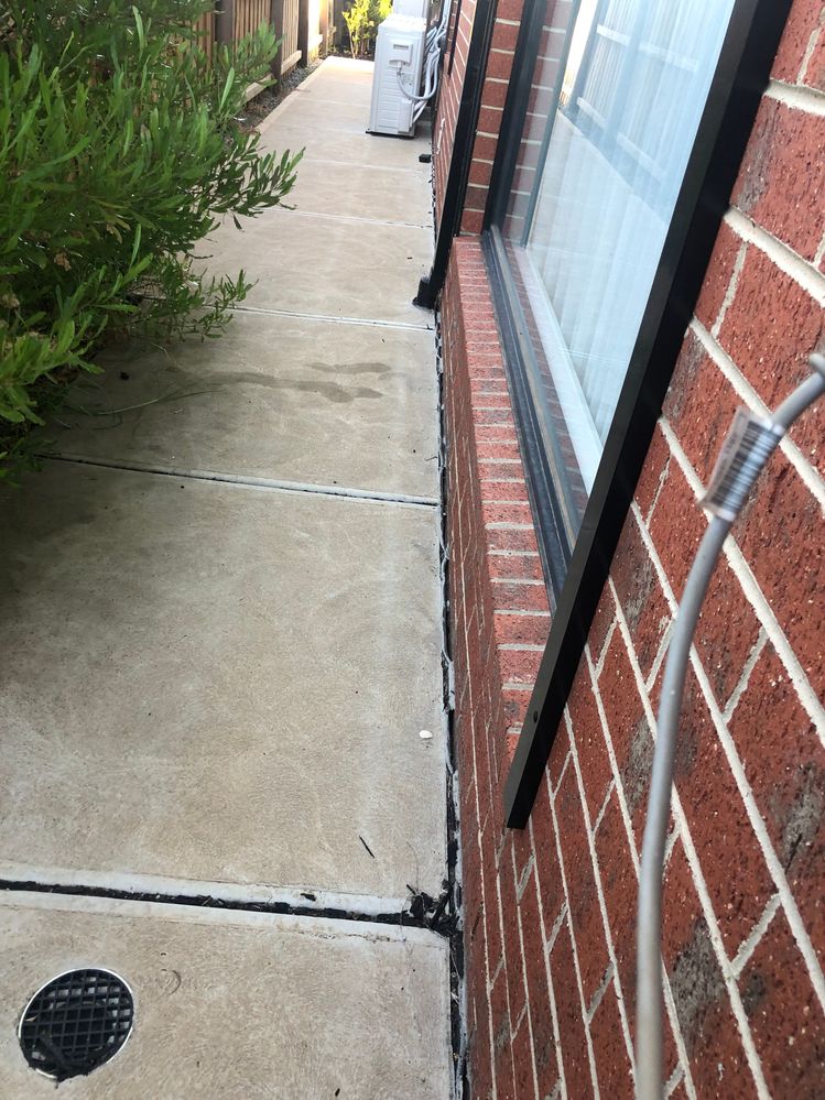

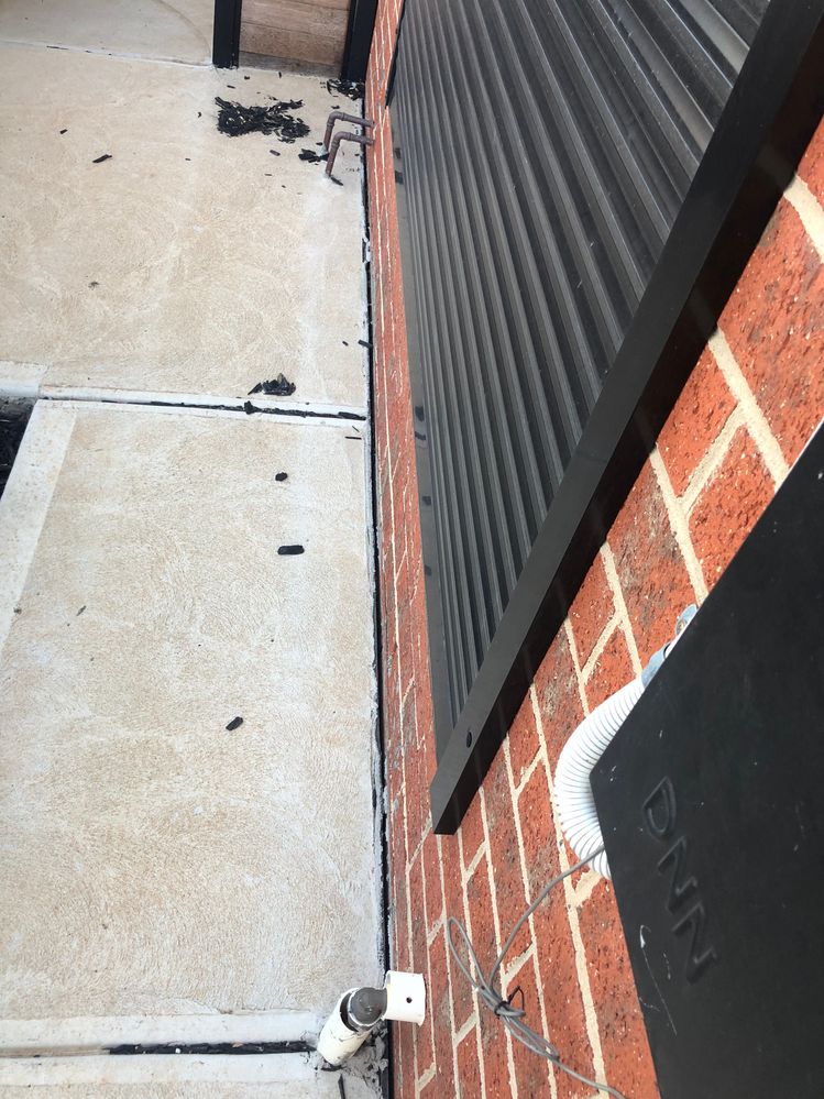

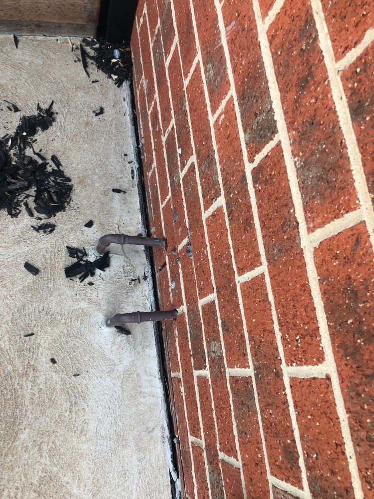

I have recently noticed gaps in between my house foundation and side concrete perimiter/walk. Looking at the sudden widening of the gap, I am very worried now.Especially if you look at the picture where you can see two pipe lines are there, and i am anxious that the movement of the concerte away from the house would not cause any problems to these pipes.
What do you think? Is it normal? How can i fix this problem?
Another thing that i have also noticed today, there is not much support on the other side of these concerte slabs. What i meant by that - on the other side there is fence and in between fence and slabs, there should be proper soil etc to prevent any movement or slides of slabs away from the house (please correct me). I have found on certain sections, the landscapping guys did not put proper amount of soli, only some wodden black chips. So it feels like there is not much of support.
I am not sure if that is also responsible for this or not.
Do i need to check with builder? pipespipes
Hello @mousom_sarkar
Welcome to the Bunnings Workshop community. It's sensational to have you join us.
If you look at the start of the discussion, you'll see that sub surface water was mentioned. This is water that enters under your slab and makes the soil soft, due to the weight of the concrete slab it will then begin to shift because of this soft soil. Your issue is a bit more concerning as your plumbing is linked to the concrete slab. To temporarily seal the gap and prevent rainwater from entering the gap I suggest using the Sika 600ml Concrete Grey Sikaflex 11FC Purform.
I recommend engaging the services of a builder or concrete slab specialist and asking them if it will be necessary to shift the slab back into position. In regards to your question of support, the slab is technically self-supporting, due to its size and weight there is no need to add any sort of anchoring device to it to keep it in place. However, its greatest strength is also its weakness, because it is so heavy any movement of the soil beneath it translates to movement at the top.
