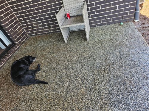

Hey I've got the pebble resurfacer max pro, I'm wanting to pull it up and put something else down in my outdoor area. How can I remove it please?

Hi Jason it's just on top of concrete. I was thinking mayb tiling it but not 100 percent sure yet. Thanks for the help.

Thanks for sharing your question about removing the pebble resurfacer on your floor. From a tiling point of view, it would be practical to remove the pebbled surface first so that the tiles will be securely anchored to the concrete base. Tiling over the pebbles is a bit risky as pebbled surfaces have a tendency to fail unexpectedly. I suggest using a tile breaker or a tile chisel to lift and break up the pebble flooring.
