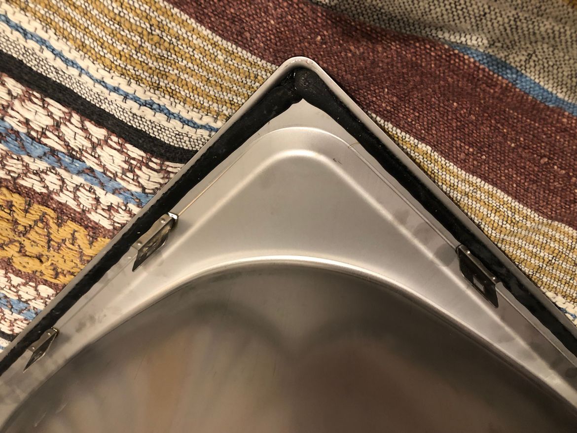

Thankyou Eric, the reason I was asking is because the laundry tub has a rubber seal all around the underside, which when the clips are in place should seal the underside of the sink. So would it still be necessary to use silicone? ( I'm not sure if all sinks have the rubber seal or not? ) Thank you for your help. HelenSee the rubber seal here all under the sink.
I tend to over engineer my projects. I would still put a bead of silicone behind the rubber seal just to make sure that it is totally sealed from water. But I will leave that choice up to you.
