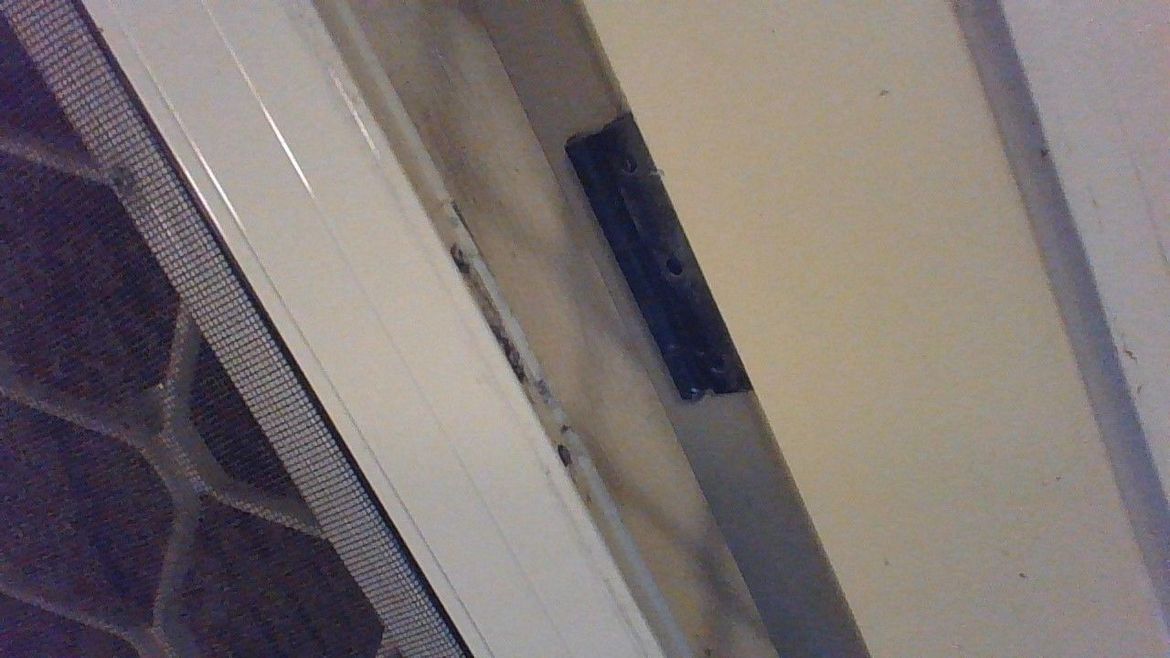

Looking for advise on how I can affix the hinge back to the screen door?
Hi @Lisa7788
Probably the best easiest solution assuming that hinge is still functional is put in larger( Fatter screws! ) counter sunk screw heads that will bite into the metal in the frame and tighten up and hold well. Ideally use a cordless screw driver to assist here.
If you have a some spare screws lying around house find 3 that fit and screw in tight. If not pick the largest screw and take it to bunnings to get the next size up in larger size screws. Ask at Bunning to help with next screw size (ie a lower Guage)
Hope his is easy for you/. Even if you have only 2 screws in that is quite good.
Hello @Lisa7788 I am a big fan of the tech screws and self tapping screws @Jewelleryrescue has suggested which will work well but prefer to use pot rivets as it provides a more secure fitment as screws can over time work loose due to the different nature of how they are designed to work.
Screws rely on the host material clamping (biting) into the threads.
Pot rivets clamp the 2 surfaces from behind/within the host material over a larger area.
If you do opt for the screws it might be prudent to also apply a liberal coat of a thread locking compound such as Locktite
https://www.bunnings.com.au/loctite-243-10ml-adhesive-threadlocker_p1560362
It's great that you've received excellent advice from @DIYGnome and @Jewelleryrescue. Just to add to the suggestions made, I also recommend having a look at the Craftright Rivet Gun Set. This is a full-blind rivet set with multiple heads and comes with a set of rivets. This will allow you to compare the rivet head that you have attached to the door.
To remove the old rivet, you'll need to use a drill and a drill bit to drill the center of the old rivet. This will split it apart and you'll be able to remove it. If you've not used a rivet gun before, I propose practicing on a thin piece of wood or steel before committing to the repair.
If you have any other questions, please let me know.
Happy Holidays!
Red
Welcome to the Bunnings Workshop community @Lisa7788. It's wonderful to have you join us, and many thanks for your question about re-attaching a hinge.I believe that using pop rivets would be the best solution. Screws are an option, but I'm concerned that the thickness of their head might interfere with the operation of the hinge.Please let me know if you have any questions.Mitchell
