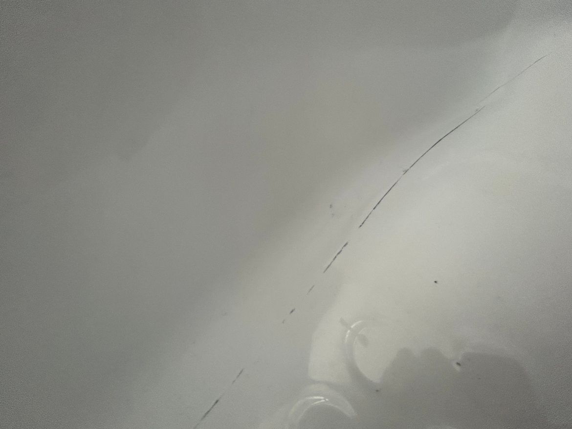

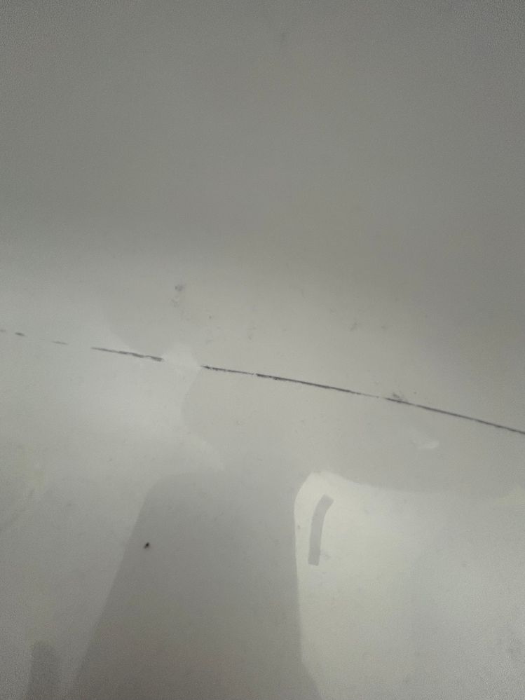

It's not a superficial mark, it's definitely an indent. Any advice greatly appreciated!
Hi @rhia92
There is a epoxy repair kit that will go along way to fix that scratch. It is sandable but the repair secret would be to fill the crack as evenly as possible maybe masking tape beside the repair before filling for better clean up.
I/N: 1560098
$18.80
Welcome to the Bunnings Workshop community @rhia92. It's sensational to have you join us, and many thanks for your question about repairing a bathtub.So sorry for the delay in my reply.
Can we ask what the bathtub is made from? Perhaps it's acrylic, metal or porcelain coated? You could look at filling the damage for a non-plastic bathtub, as @Jewelleryrescue has mentioned. I'd suggest for a convincing repair you'd then need to coat the tub with a product similar to White Knight 500ml White Tub And Basin Paint.Please let us know if you have any questions.Mitchell
