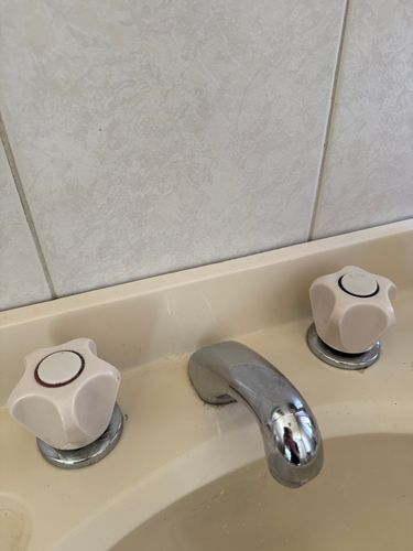

Hi there, just wondering how to remove these taps - I can get everything off except the chrome base, it seems to be stuck / can’t get a grip on it to shift it, but not sure if I’m missing something! Cheers
Welcome to the Bunnings Workshop community @renobaby. It's marvellous to have you join us, and many thanks for your question about removing tap cover flanges.The cover flanges could be siliconed to the basin, so running a retractable knife underneath them can help cut the silicone and separate them. Remember your safety glasses, cut-resistant gloves, and to cut away from your hands. They could be screwed onto the spindles and require you to grip them with multi-grip pliers. Be careful not to scratch them up if you intend on keeping them. Applying some masking tape to them can help prevent this.Please let me know how you go and if you have any questions.Mitchell
Remove the blue and red buttons, nut inside, then tap knob. The chrome base could just be stuck by soap scum and dried mineral deposits. You can try multigrips, but cover the chrome flanges with the silicone grippy cloth stuff that is often used to grip jar lids to remove them, also often used in cutlery drawers to deaden the sound. It’s often blue or green soft mesh stuff. Be sure to turn anticlockwise in case the flange is screwed on with a thread. Mitchell’s suggestion about their possibly being siliconed on is also a good one. Good luck.

I trust @renobaby appreciates your response. I love the idea of using a silicone cloth, as it sounds just about grippy enough to get a hold of those chrome flanges.We look forward to having you share more of your knowledge with the community. Please feel free to reach out anytime you need assistance yourself or have something to share with the community.Mitchell
