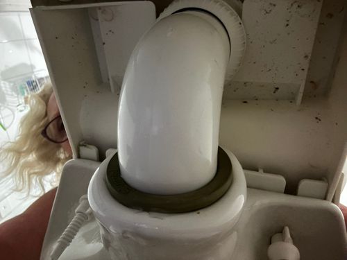

Hi l have attached a photo of a leak in the gasket - toilet between the tank and bowl. Could l get some assistance if this is easy fix or need a plumber.

The parts you are after are the Kinetic 50mm Flush Pipe Ring and the Kinetic 50mm Key Seal. When the key seal is changed quite often the flush pipe O ring is changed as well. In this particular instance, I suggest engaging the services of a registered plumber as this is a difficult repair job and not recommended as a D.I.Y. repair.
Depending on the difficulty level the plumber might have to remove your cistern to gain access to the flush pipe. The flush pipe will then need to be pulled out and the old key seal replaced. The pipe will then need to be forced back into position making sure that it lines up with the outlet of the cistern.
