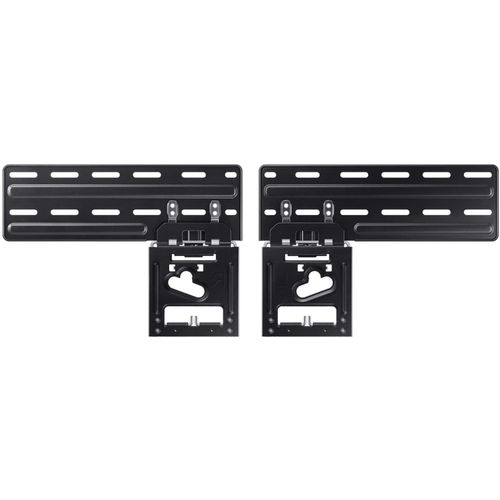

Hi! I'm planning to mount our TV in our living room wall and wanted to ask for tips. In particular, I wanted to ask what materials I should pick. Here are some details:
- I have a Samsung TV Frame 65 inch, also have a TV mounting kit included.
- I've checked for studs on the wall and noticed its too far apart for the mounting kit to screw in.
- I have some tools in hand, such as small saw to cut drywall, spirit level, and several power tools for screws

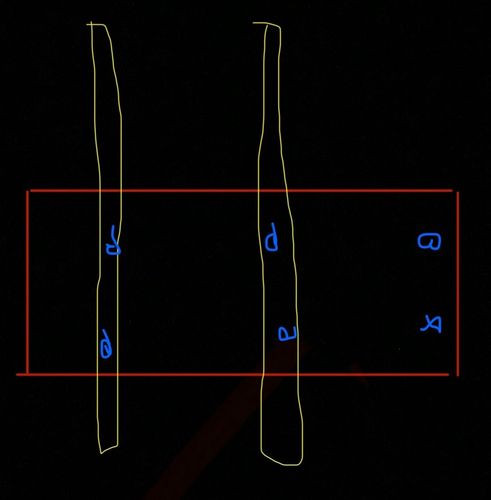

My plan is to install a wood panel board in 3 vertical studs, I'll cut a part of the drywall where the panel board will fit in place.
Then place the TV mount into the wood panel board. Basically I would have a horizontal sturdy stud instead of relying on the vertical studs that are too far apart.
I wanted to ask are:
- what kind of panel board should I look for, or what type of material or timber? (I don't know if those are the right questions to ask, I'm open to other ideas)
- what screws should I use? I could see there are silver and gold screws available in Bunnings, but I have no idea if they are safe to screw both the stud and panel board together.
- what things should I consider other than what I've already described? Any tips would be helpful just be nice when saying it.
