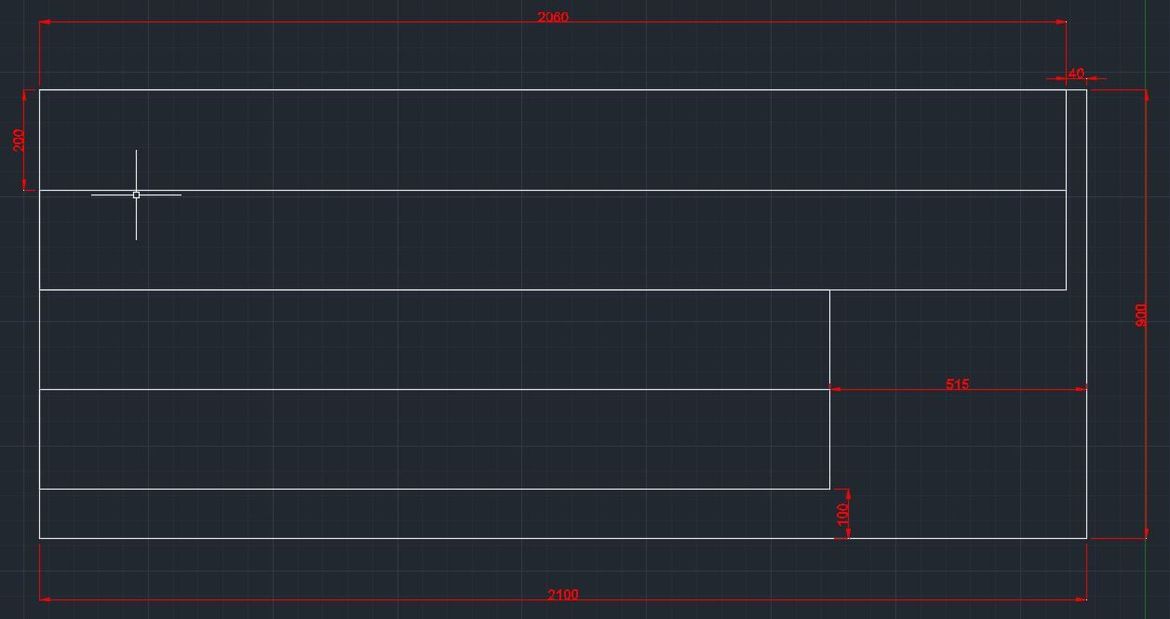

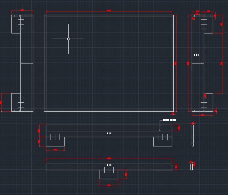

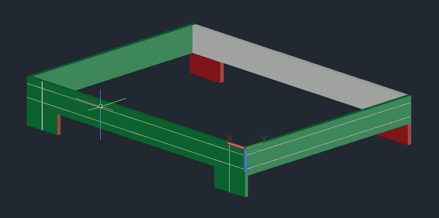

Yes, I have drawn the plans in Autocad , here below the snap shot

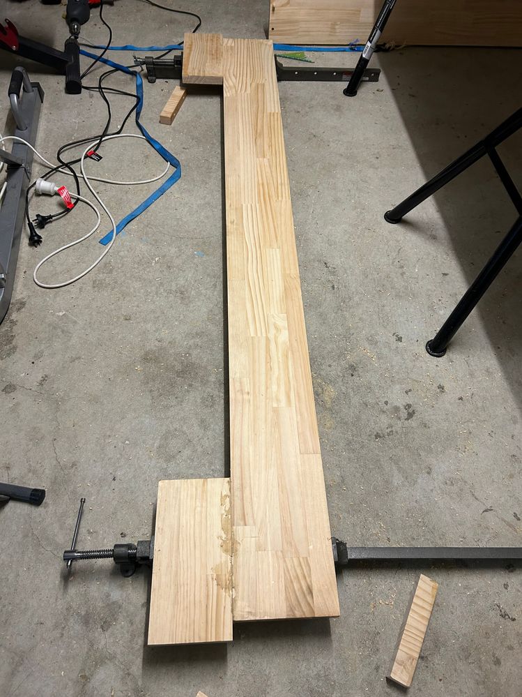

I have bought 2100 L x 900 W x 30 Th mm specrite panel from bunnings tarneit and cut it into
2060 x 200 - 2 off
1620 x 200 - 2 off
and some legs as per the drawing , this will be the main load bearing section
can you please suggest that the 2060 x 200 x 30th sections are capable of taking up the load without bowing andd breaking
Hi @slk,
These lengths of finger-jointed timber are equally strong as standard solid timber. In fact, you'll find that if they do fail, it will typically be on a section of timber and not at the glued joint. However, beds of that size generally have a couple of feet in the middle under the slats. Not only do these feet prevent the slats from sagging under weight, but they help support the sides and prevent them from cracking.

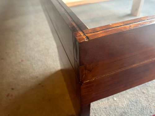

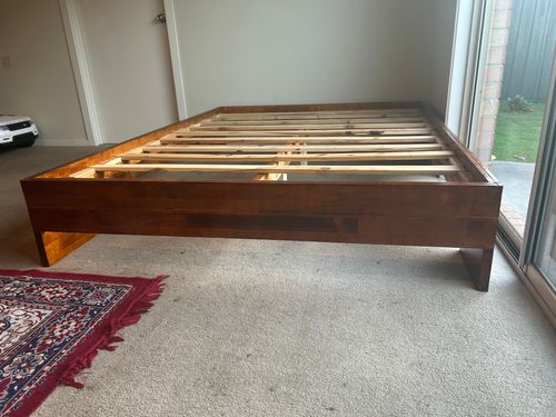

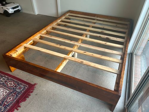

Project completed
Thank you very much for posting that update. Your bed frame looks fantastic! The design looks very strong and it's good that you placed a center support for the slats. The slats should support your mattress very well.
Again, thank you for sharing this excellent project.
