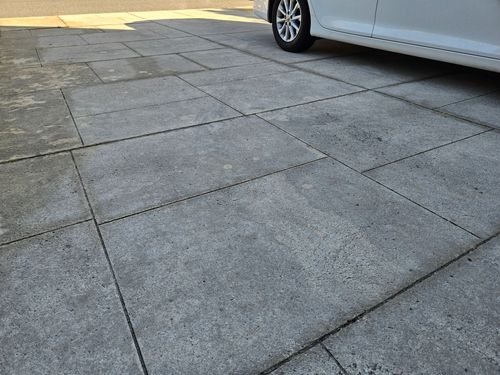

Hi, I have a limestone driveway which unfortunately used a very high pressure to clean it and it has now lost its texture. How can I repair it?

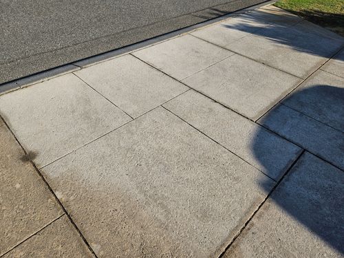

Thanks for your response. It was a rough surface that has become smooth. I could see small particles of the stones coming off the surface when I was washing it.. It has lost its original cream color. Even on the edges of joints you will see discolouration as if it is still wet.

Are you fairly sure that it's a limestone driveway and not a stamped concrete drive? I wouldn't have thought that limestone could have its colour removed from pressure washing as that colour is consistent the whole way through. It sounds like there has been a painted coating added when the concrete was stamped to look like pavers and that's what has been blasted off.

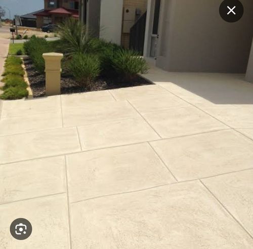

I searched fpr liquid limestone on the web amd can confim that my driveway looked exactly same as attached photo.

Oh, that makes sense, Ken (@Kmaz).
Limestone is a solid block that is quarried. Reconstituted limestone is a solid block that is created.
Your liquid limestone is effectively a painted coating over concrete to create an imitation limestone look.
If you've blasted that coating off, you need to enlist the services of a professional who deals with that type of product and coating to have it re-finished. Alternatively, you could look at painting the driveway in a limestone-coloured paint.
