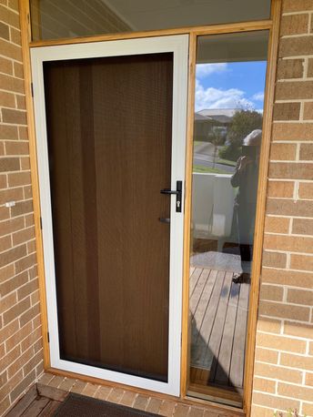

Can I ask that you upload some photos of the door opening so that our helpful members can provide more specific advice on this issue? Please let me know if you need a hand uploading images.
We'll need to see those images to give an informed answer, but I'd suggest that the addition of a door bottom seal and foam door seal around the perimeter of the door would go a long way towards minimising and sealing the gaps.

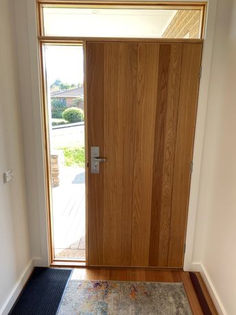

I suggest a photo from the outside showing the whole door, a photo from the inside showing the whole door and some images specifically of the gaps around the door. These photos should be adequate for our members to make an assessment.

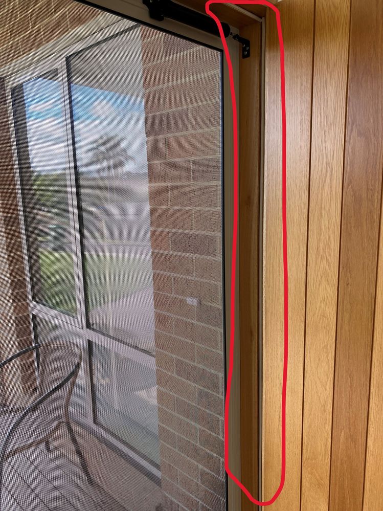

Based on the photos you have sent me; it looks like you already have a weather strip around the frame of your door.
Can you advise if you've added this recently or was it existing? If it is not new, can you identify where the wind is getting in?
Adding a draught stopper such as Adoored Fabric Draught Stopper or Sperling Sausage Dog Draught Stopper inside at the base of the wooden door might stop the draught getting through beneath the door.

When the wooden door is closed, can you see the weather strip around the door compressing?
These weather strips rely on the foam compressing against a surface to stop the flow of air in behind. If you are still experiencing draught coming around the door, it may be a case of the door not compressing the foam enough. If this is the case, you may need to consider removing the existing weather seal, measuring the gap when the door is closed, and adding a thicker weather seal to suit.
Something like this Moroday 16 x 10mm x 5m Black Self Adhesive D-Shape Weather Strip might be suitable depending on the size of the gap. You'll see that this strip is designed with a cavity in the centre which allows the weather strip to compress, creating the seal you'll need to stop the draught.
If you find upon inspection that this is not the reason for the draught continuing to get through, we may need to do some further investigation.
