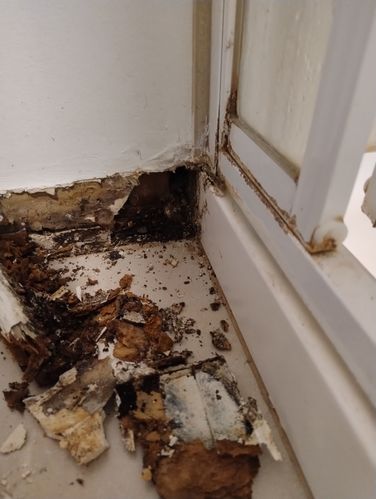

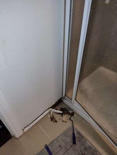

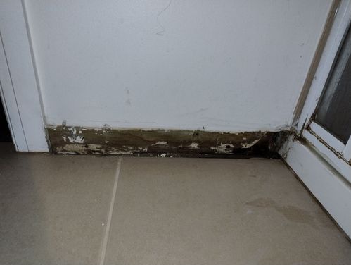

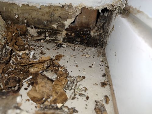

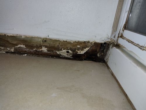

Noticed some wood rot near the shower in our house we recently moved into. Tore out the skirting and now not sure what to do next. I've attached pictures for reference. Any suggestions would be appreciated. Thanks

Unfortunately, this one doesn't look like there'll be an easy fix and will likely require extensive remediation work and the assistance of suitably licenced tradespeople. You can see where I've circled in the below photo that the water has gotten in and is rotting the bottom plate of your wall.
This means that if there was a waterproofing membrane in place, it failed, allowing water to penetrate inside the wall cavity, causing a damp area where rot thrives. The extent of the damage can't be assessed without removing wall sheets and finding the source of the leak.
The fix would involve removing the wall sheets to assess the damage, replacing whatever wood has become rotten, then reinstating the sheets, applying a waterproof membrane and sealing to prevent further water damage. It would then require painting, tiling and finishing, depending on how you decide to finish the job.
I would suggest this job would require the assistance of a builder as the damage could be extensive once the wall sheet has been removed. It may be worth contacting your insurer to see if this is covered, as the repair may be more expensive than you think.
