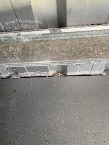

Just wondering the best, neatest way to seal the floor of this shed? The corrugated nature of the wall is vexing me. Thanks in advance
Welcome to the Bunnings Workshop community @StevenT1. It's wonderful to have you join us, and many thanks for your question about sealing a gap.If you remove the lower set of screws fixing the sheet to the beam/slab, you should be able to insert Crommelin 940mm Trimdeck Ridge Superseal between the sheeting and the slab. It has the same profile as your Trimdeck sheeting, so it will fill the gap neatly. Once you re-install the screws, they will compress it and seal the area.Please let me know if you have any questions.Mitchell

The link is still active, but being unable to find it through search could be a location issue, as it is not stocked in your area, @StevenT1; that doesn't explain a 404 error, though. We also have the Suntuf Access Black Trimdeck Infill.If you can let me know your nearest store, I can check stock availability.
I cleared my history etc and the link worked again. I’m in cairns mate, if both products are essentially the same thing then I’m happy using either. I do appreciate your time and your help too. steven

I can see that Bunnings Cairns has the Suntuf Access Black Trimdeck Infill in stock. The Crommelins version is a Special Order item. Both do the same job.
