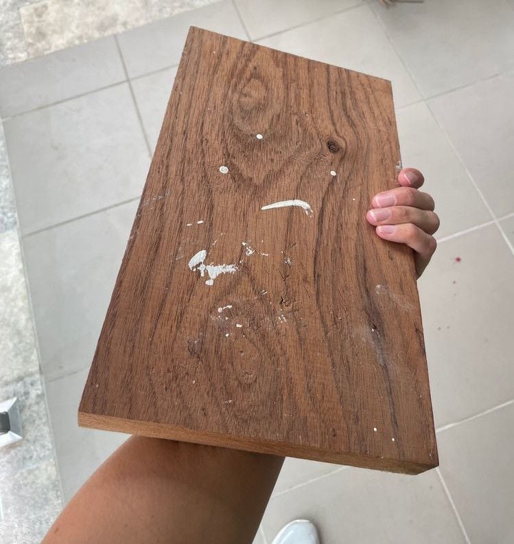

Step 1
Firstly, I found a piece of scrap wood and got everything out that I needed.

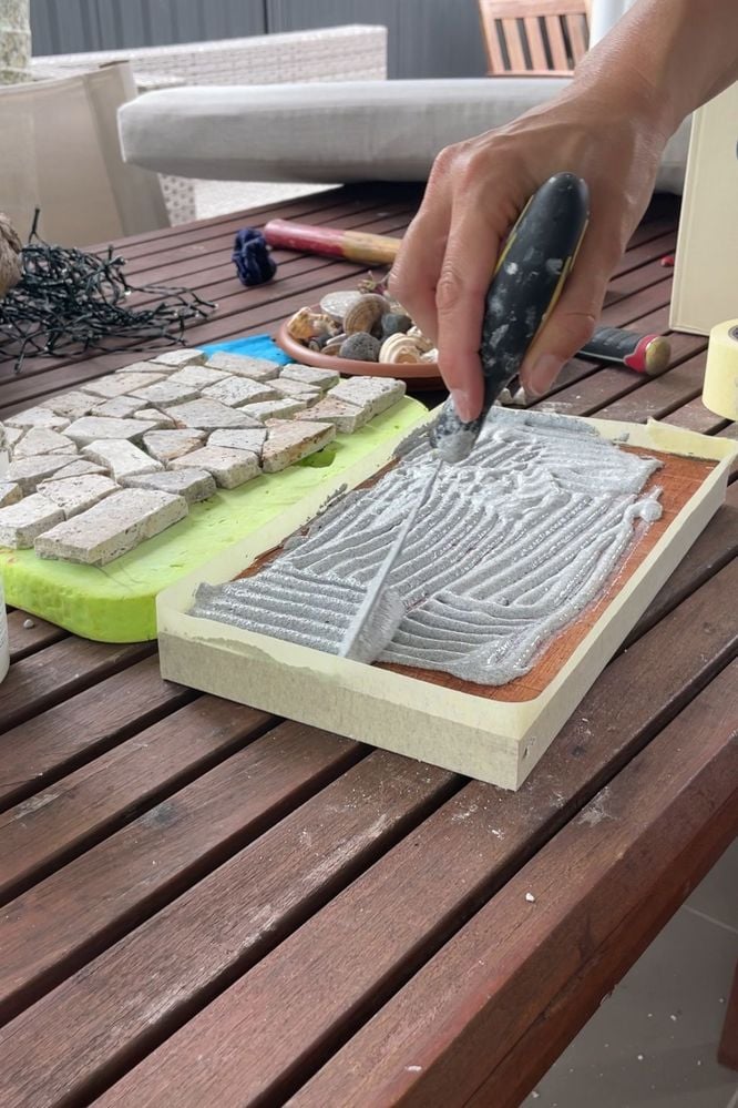

Step 3

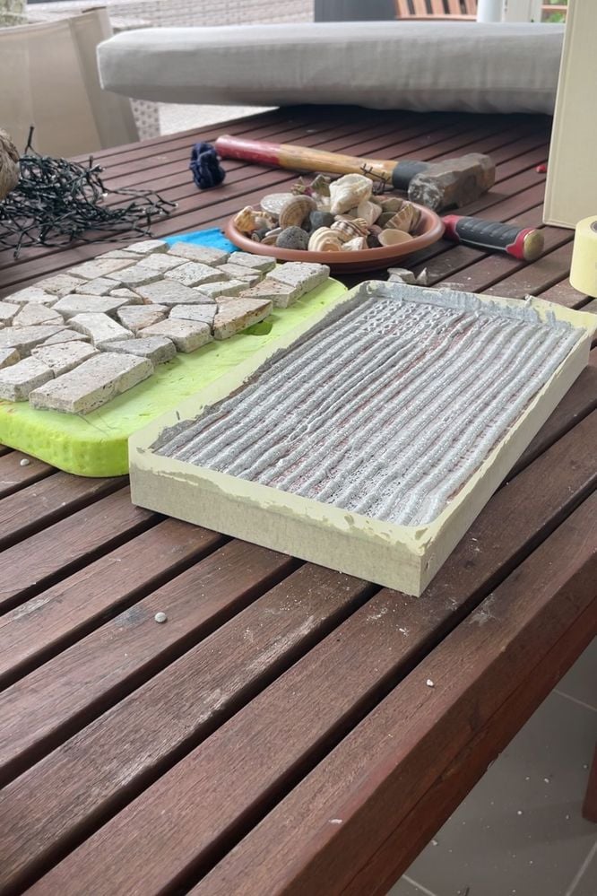

When I was happy with the pattern, I transferred them off the board so that I could apply the adhesive. I taped around the edge of the board to hold any loose adhesive in place. Then using the adhesive scraper, I applied the adhesive and scored lines down the centre like this.

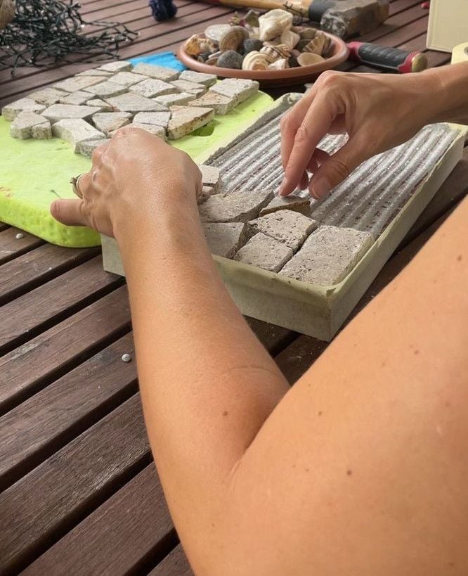

Step 5

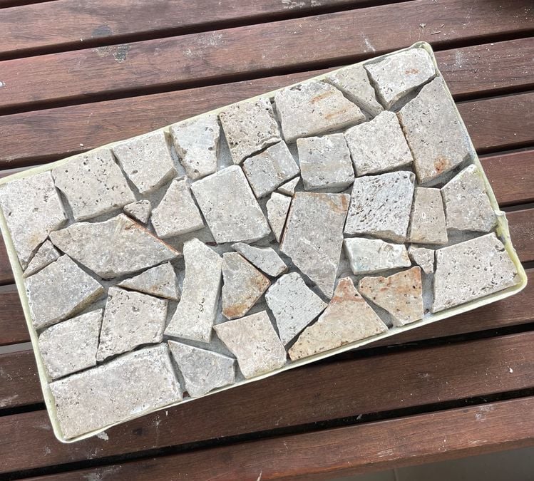

Then I placed each tile back on the board. This is so satisfying to do.
Step 6
Once all the pieces were in place, I left it to dry for 24 hours.

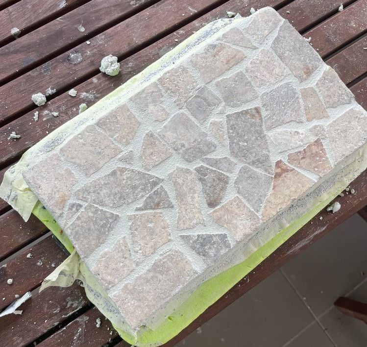

Step 7
After the adhesive had set, it was time to grout. Once mixed with water, the grout is a thick paste. I applied it using my gloves and pushed it into each crevice. I then used a damp sponge to smooth it out and remove the excess.

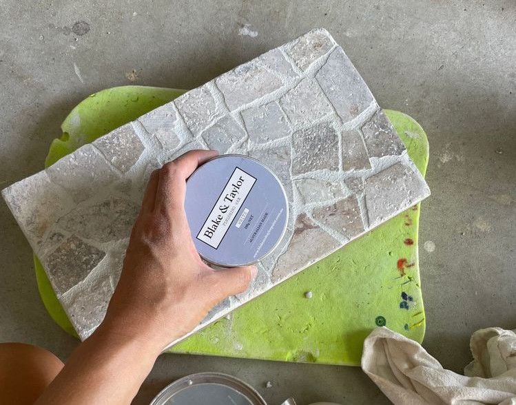

Step 9
I then waxed the entire piece using white wax. This sealed the grout and tile and makes it easier to clean.
