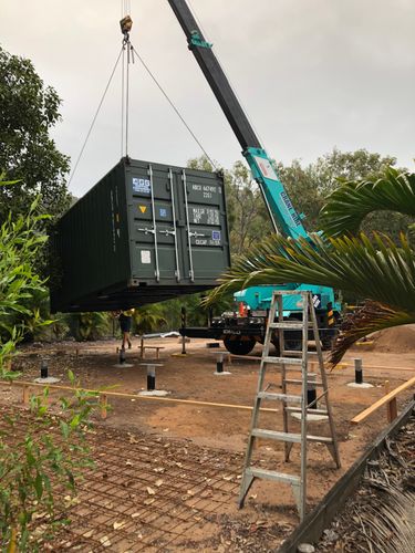

Find crane to put containers in position, and time it so the cost of bringing the crane on the barge could be shared with other jobs on the island.

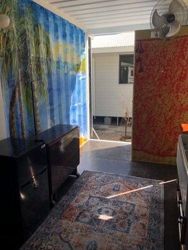

Design interior layout. Eg. Does it need shower? Decided to put it outside (it’s FNQ so hot enough) to save internal space.
Step 5

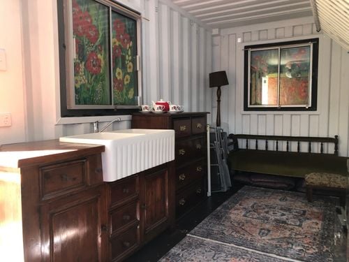

Choose style, as this affects what furniture and appliances. Wanted something cosy so went with retro/granny-flat/Victorian with walls and shutters hand painted by a
local artist. A butlers sink, high gloss solid timber furniture, retro lighting, tea pot with cosy, and an antique chaise longue added to the feel. In first photo container door is open, but normally this is closed.

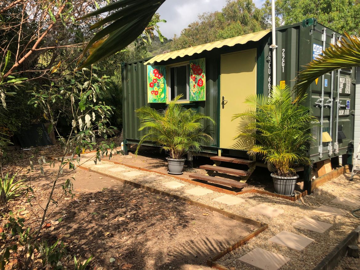

Step 6
Landscaped around it by adding plants and pavers with pebbles to soften its look.
