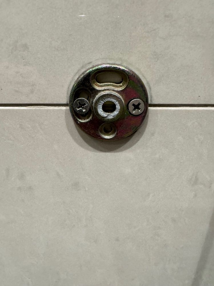

My wall mount of towel rail is broken. Any glue recommendation for a metal to metal glue to fix this?

Is the fitting cast aluminium? Or will a magnet stick to it?

The reason I asked the above questions - is I'm more than happy to weld the lug back in place - provided it's steel and not aluminium.

I think it would be fairly easy to weld that lug from the back, especially as my eyes see an indentation at the back of the bracket - provided this is a steel product.
But looking closer at your photo - is it fractured die-cast aluminum alloy of sorts?

I received the fittings at midday today and I gotta admit - they're a lot smaller than I thought. And alas, they are all cast aluminium alloy. The protruding lug is hollow and there is not the recessed area at the back as I previously thought. They are also 10mm diameter.

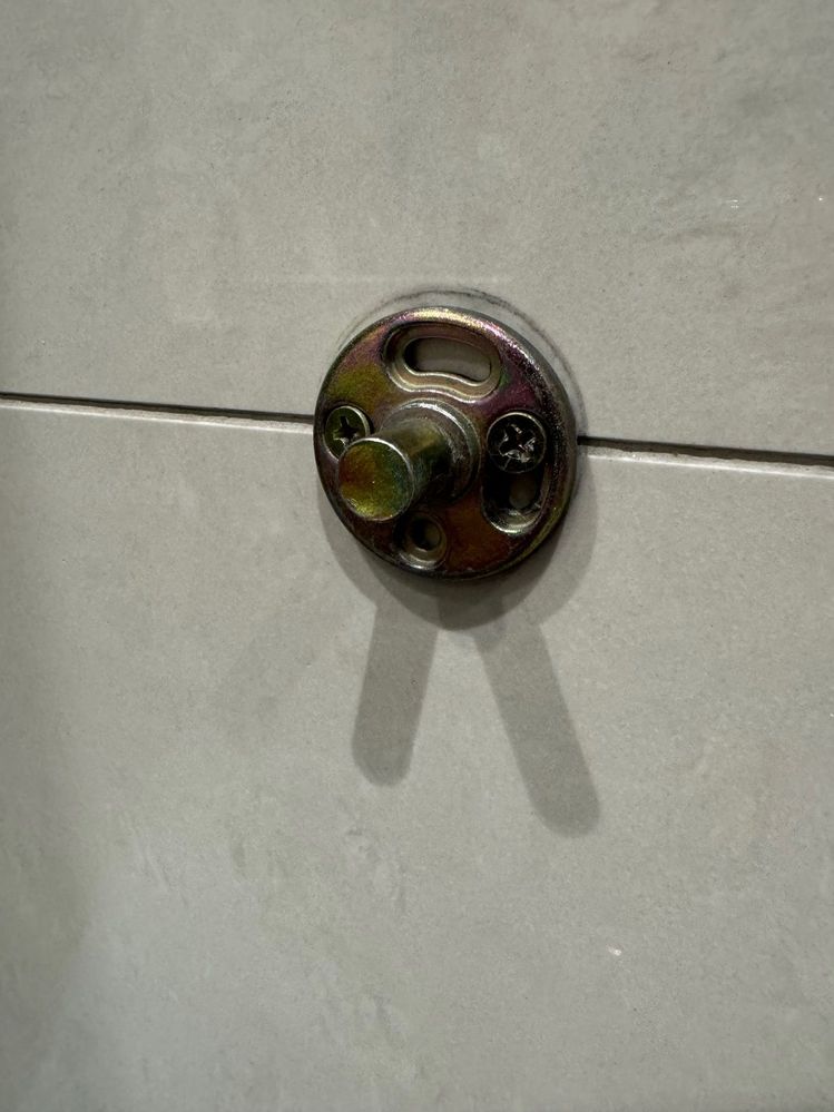

So I changed tack again. I drilled the fractured hole out 8.5 mm as there is a generous 6 mm of thickness to play with. Found a piece of chrome 10mm diameter steel rod and cut a 10 X 1.5 thread one end. Cut to length and drilled out a grub screw position.
Now my question is, I was going to secure it with a thread glue - but being different metals, should I?

Although they are different metals, I agree they should be secured by thread glue.
OK @bernalee
Glued it is, and I'm baking it. Once cooled, I will package it up and head to the Post Office later this afternoon.

I received the repaired mount today. It works perfectly well. Thank you so much for your kind help and professional work!😄

It looks like an extremely sturdy repair that will last for years to come.

With an outside diameter of that 'peg' at 10 mm that incorporates an 8 mm hole - leaves only about 28 square mm of alloy holding power.
