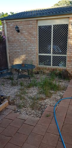

1. Clear the space and measure the distance from wall to each post. Making sure distance between posts measured for horizontal post.

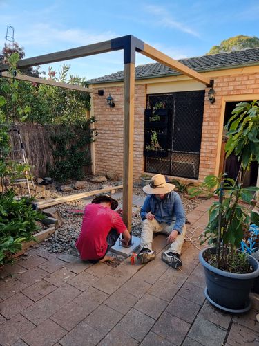

4. Place upright poles in base plates of pergola kit and joint on correct ends. Connect horizontal post to joints of vertical poles. Stand up vertical posts on cement pavers.
5. Add horizontal posts with wall bases into joints (2 ladders needed for this process).
6. Drill holes for wall posts. Secure into place with bolts.
7. Check everything level and then secure vertical posts with bolts.

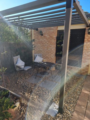

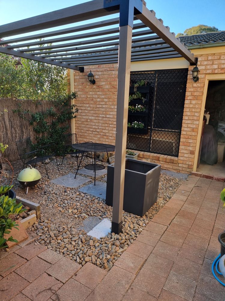

8. Measure and place struts across top of pergola. Secure with two screws each end.
9. Paint pergola first coat and leave to dry.
10. Paint pergola with second coat.
