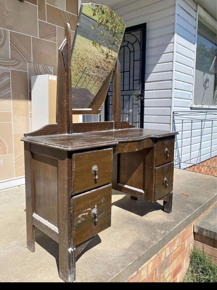

Originally purchased from JA Booth and Co Furniture Store in Newcastle.
The mirror was in good condition. Cleaned the mirror claws and
The handles could not be removed without damage so individually cleaned and polished these the best I could prior to taping them for protection. Replaced the base of one of the drawers as rotten.
Lightly sanded and cleaned the dresser.

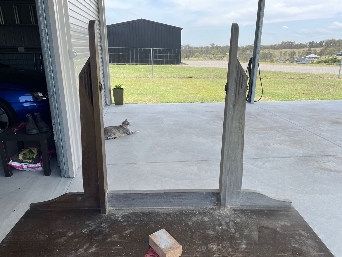

I used a180 grit sanding sheet and a cork block and rolled pieces to sand back the scratches and the old paint throughout the dresser. Also to ensure any dry splittering areas where also smoothed back. This included the mirror frame.
Once sanded, this was dusted then wiped over with warm water and left to dry prior to painting

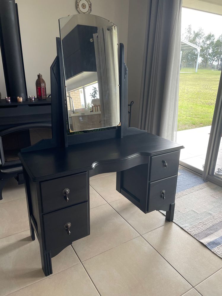

Using an compressor spray gun, I watered down the paint and tested the consistency so it was not too thick or watery where it could run. I applied one light coat and allowed it to dry, then applied another. This was repeated, so three light coats where applied to build up the application without the paint running.
Step 6
6. Varnish
I used a soft brush to apply the varnish using a thin application (to avoid brush marks) and repeated the application once dried.
Once dried the masking tape was removed from the handles of each draw.

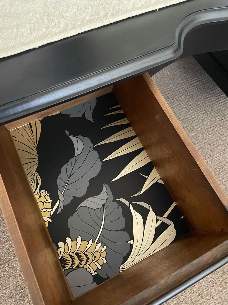

I decided to wallpaper the inside bottom of all the draws with some lovely leftover wallpaper I had which suited the black design.

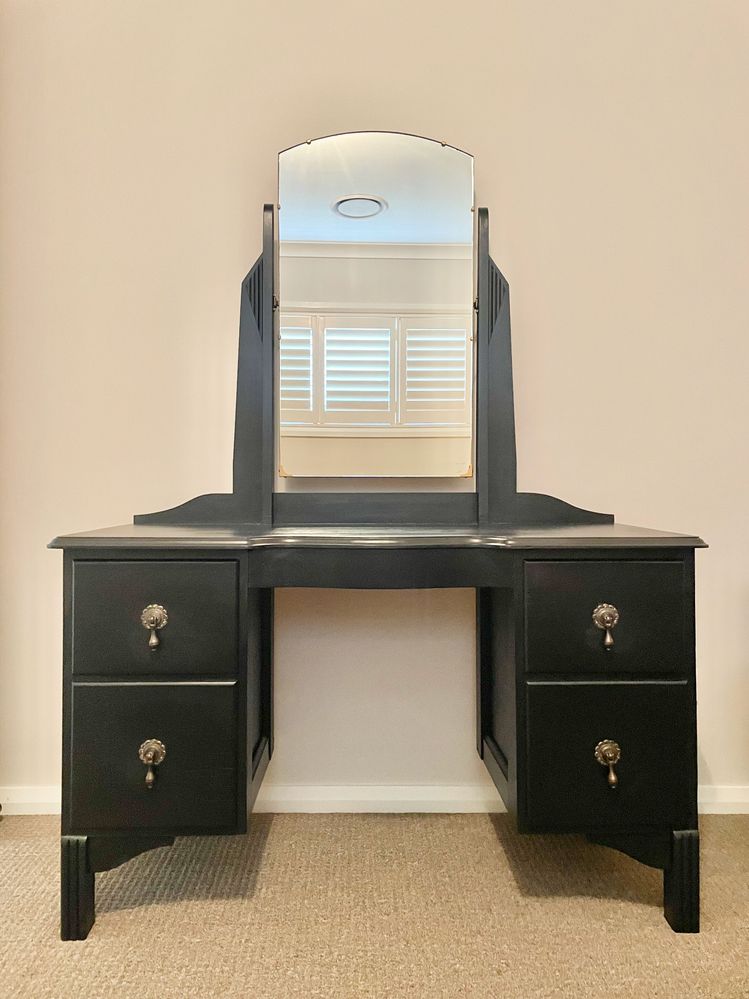

8. Completing the Dresser
The mirror was put back together with the freshly painted gold claws etc. The movable hinges were also placed back onto the mirror supports which enable the mirror to be tilted.
