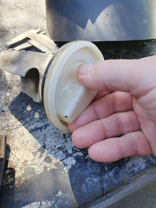

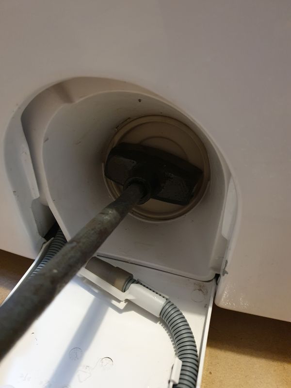

An old Whirlpool front-loading washing machine we have has a filter that should be removed and cleaned regularly, but with age, arthritis and past finger injuries - I'm finding it harder and harder to remove (especially being so low to the ground), clean and replace with enough torque to prevent leaking.
Until today.

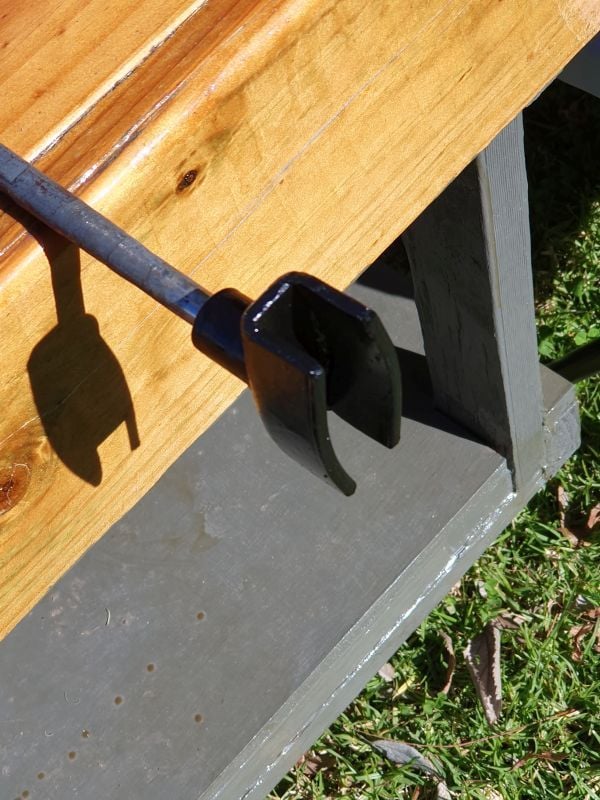

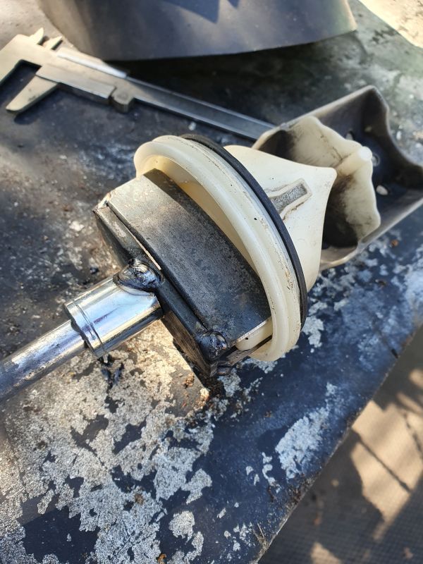

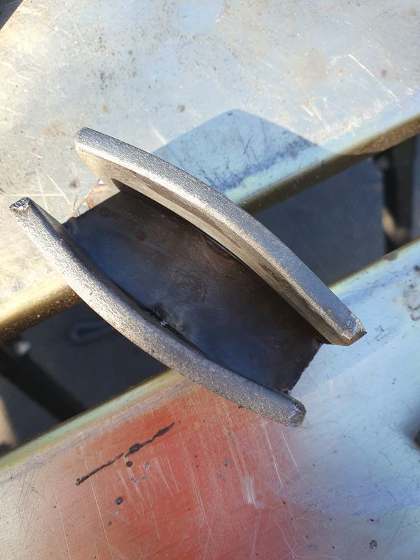

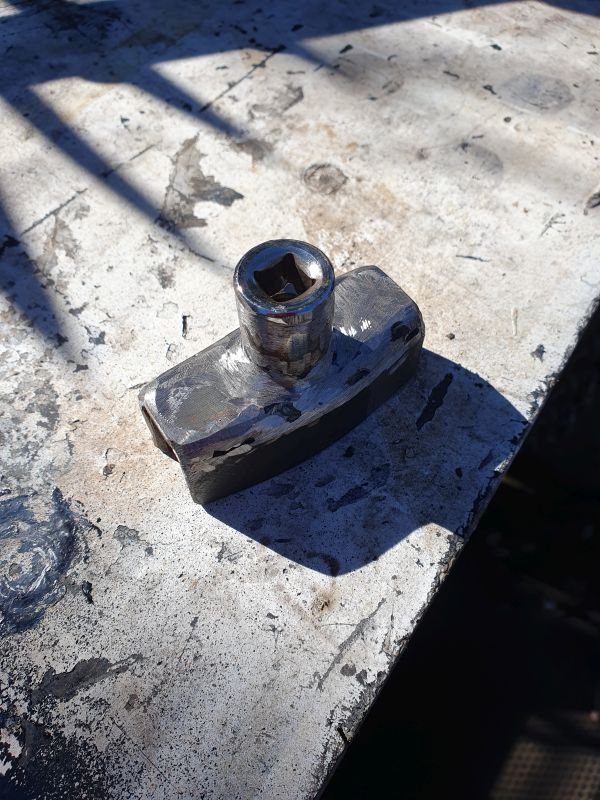

I made a 'socket' to fit exactly the handle shape.
