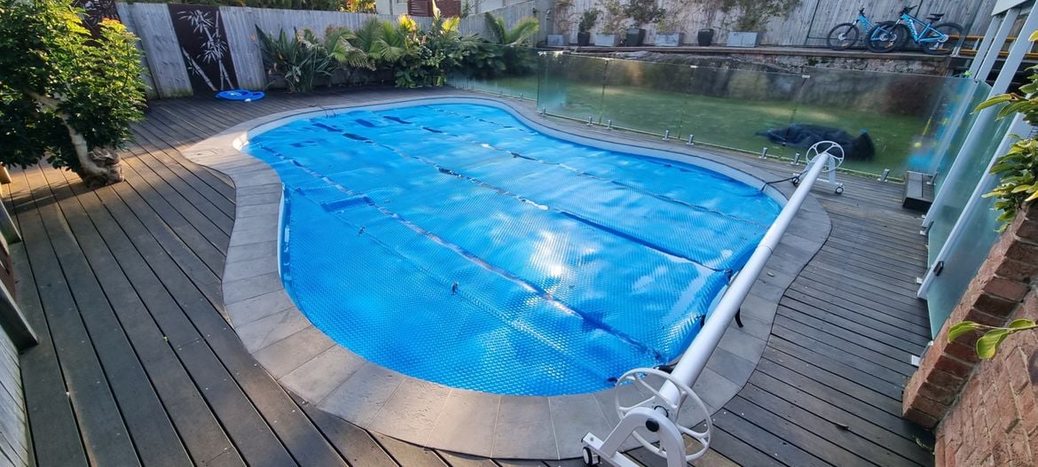

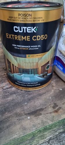

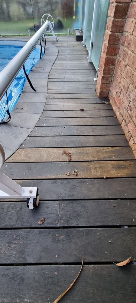

We've just bought our first home, and we've inherited a double deck and pool deck. The previous owners said I could simply put a new coat of deck oil on the deck, and left the remains of a tin of Cutek oil. The marketing blurb seems to indicate I can do that also.
But on closer inspection and talking with some of the staff at Bunnings, I am not convinced.

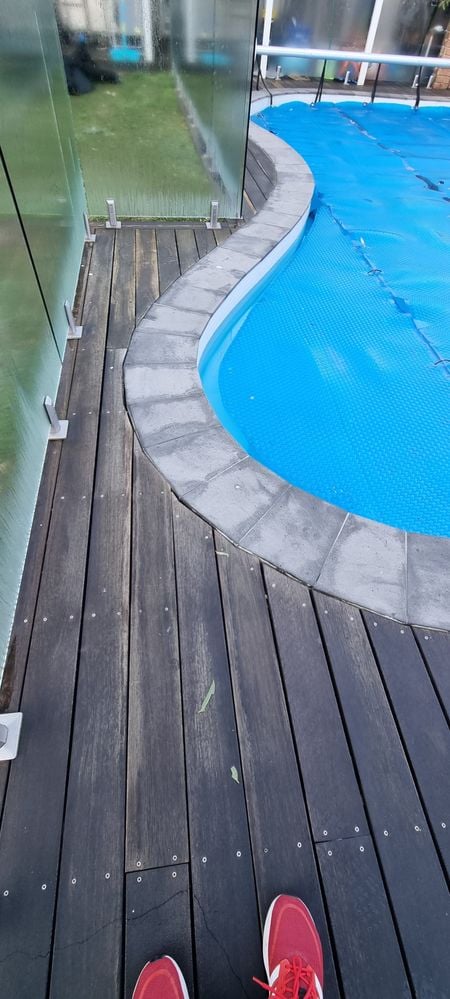

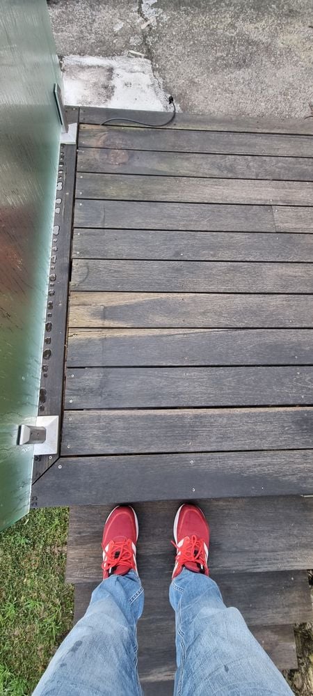

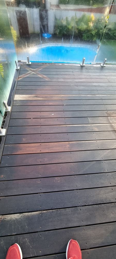

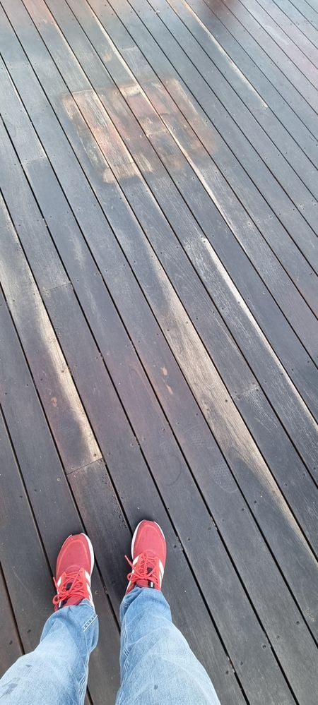

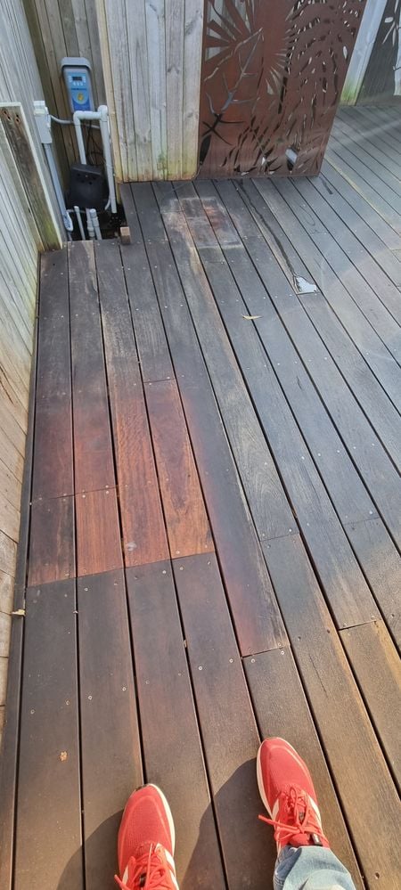

I can see the deck has a number of patches where oil is worn off, and what appears to be remnants of an earlier decking product. I'm also not convinced this is the actual colour though this doesn't look bad at all.

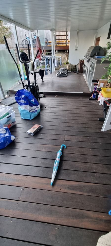

I guess I'm trying to work out if I can just apply the old prouduct, pressure wash or desk scrub, or if I will also need to sand this back (there is quite a lot of deck here).
So I have a few questions, I would really appreciate help with.:
What wood is this?
Does anyone have experience with this Cutek or equivalent product? Seem Bunnings used to carry this but have since discontinued it.
Should I pressure wash/deck scrub or both?
Should I sand back?
I noticed the desk scrubbing chemicals say 'poison' on them, so I'm a bit concerned about using next to the pool - any advice?

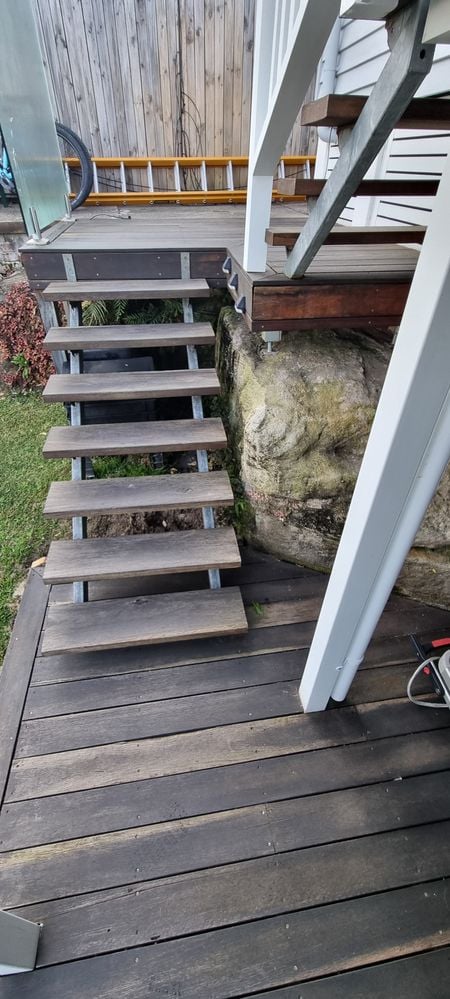

One of the decks is elevated, do I need special precautions here?
Is winter a good time to do this, or should I wait for warmer weather?
