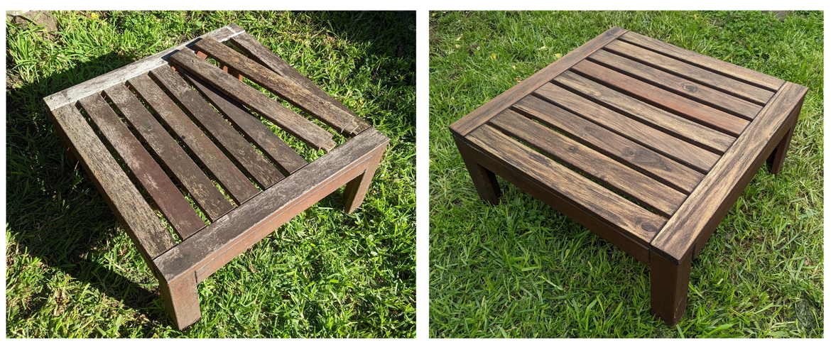

The top surface of the table pretty bad and was going to have to be stripped back to raw wood. First though, I had to deal with the two broken panels.

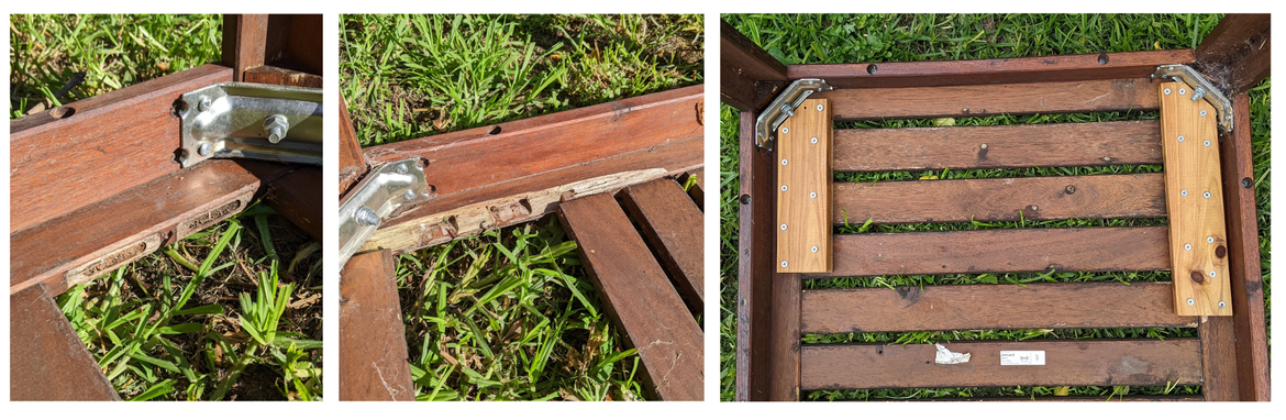

The original sockets and pegs for the two panels were broken so I had to brace them with some scrap pine wood. Several screws later, they were set to the right position and strong enough for someone to sit on it.

I now set to working on the top surface with all panels in place. Using an orbital sander and 40 grit paper it stripped back to raw wood easily. Working through 80 and 120 grit paper smoothed it out nicely.
I did a single coat of dark stain which still let through the wood grain. To finish, I coated the lot in raw linseed oil. Frankly, I think it came up a treat. Definitely better than binning it and buying something new. I hope to now do this more regularly before it get to such bad condition again. Now to do the matching chairs ...
