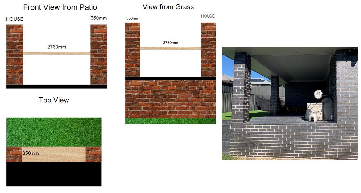

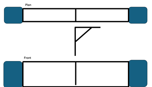

I have a patio area, tiled and under cover. We have a space between a brick pillar and the house and I'd like to build a bench between them. Not to sit on, but as like a bar type bench where my wife and I could have breakfast on, I could take the laptop to for working outside. My concern is the weight in something relatively floating between since it's a long bench I'd like to build. Photos below of some insight. I'd like some recommendations on how to do this with minimal needs for supports coming down to the ground if that makes sense at all. At some stage later also, we may be putting glass panels or wire fencing underneath the bench.
Things I've considered
- Welding a metal frame to bolt to either side and then a timber top (haven't welded before)
- As above, but with wood
- A timber block bolted on each side and the bench on top.
Please offer any insight. I've not building anything weight bearing like this without legs and frames!
