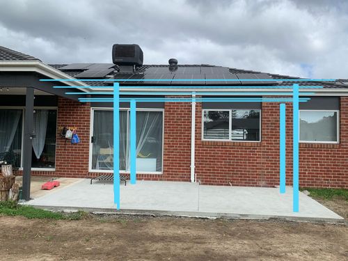

I am building a pergola and I have 2 options to attach a waling plate:
- through facia into rafters
- directory to the brick wall
i think it will be easier to do it into the brick, but are there any downsides? any recommendations please?

i now think that installing posts at the back of the pergola and install beam on the posts won’t be more expensive than attaching pergola to the house as engaging a tradie will quickly make up the difference or even make this option more expensive. Would you agree?

it isn’t as straight forward as I will have to have quite a span for beams on the left side as I don’t want to install the post in front of the entrance. I guess I can attach pergola’s beams to the alfresco’s beam? What is your take on that?

I would advise against it as the alfresco beam has been installed to carry a certain amount of weight and to withstand a certain amount of force. Changing the parameters of the load and weight might have unintended consequences on your roofing frame. I suggest either shortening the beams or adding an extra post in the middle along with a support beam going across.

sounds like having shorter beams and having my pergola detached is my best option then.
How do I know what is the acceptable length of the beam overhang? Is there a table of sorts?

Hi @Alexey,
There are some beam span tables from our supplier Woodhouse. However, large overhangs are not acceptable. I'd suggest you need to put your posts at the end of the beam. So one post is next to the existing and the other on the side of the door closest to the alfresco beam. You can then use large beams to span the distance between the two sets of posts, or include mid posts to halve the span.
