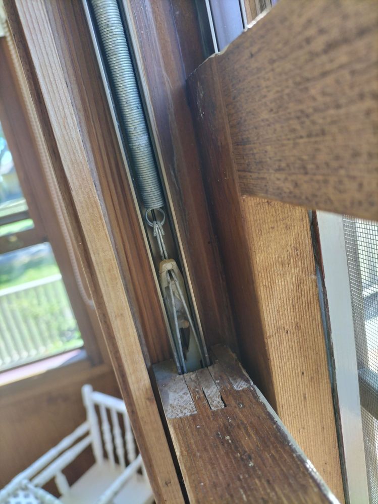

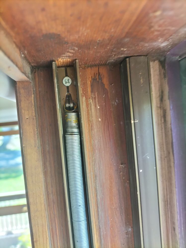

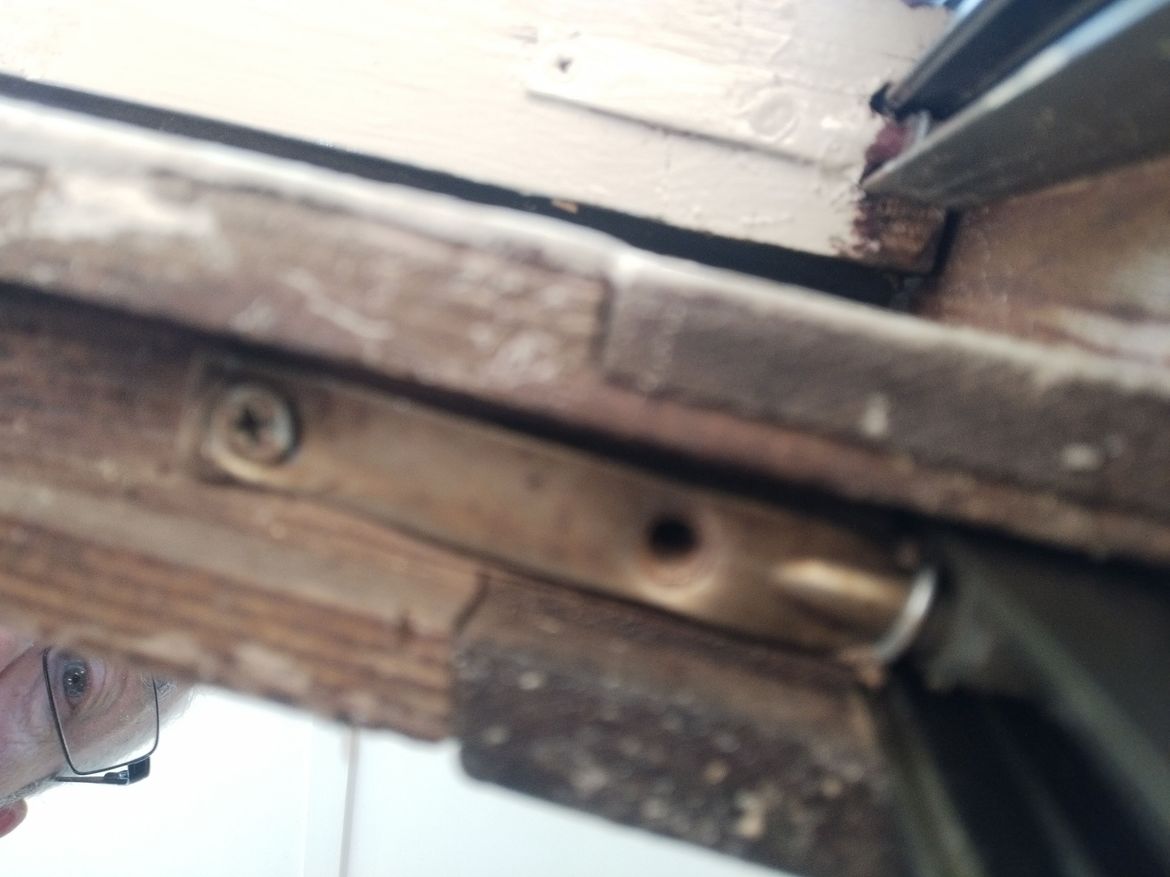

How do you replace balance springs in double sash non tilting windows. The springs have come adrift from the bottom of the window frames and the attachment clips are broken or lost. How do I replace these fasteners and also the spring guide within the frame attached to the spring

Thank you for your patience. I've gone into the hardware isle of the store and there are springs available for your window. I suggest bringing your old set to the store so that you can compare for length and width to make sure you get the correct one. However, I could not find any of the other parts for a sash window.
I propose speaking to a builder or handy person who is familiar with traditional spring-loaded sash windows and asking them if it can be upgraded to Window spiral balance sets.

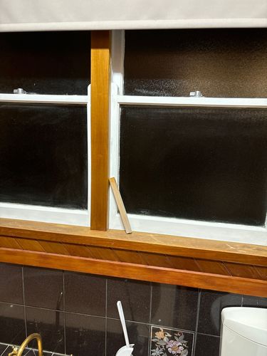

Hi @Mark_Harris , I have a sash window the springs are broken , there’s a lot of information on YouTube of how to repair them, there iare sites that supply the replacement units, however you will need to remove the old ones and take it with you to match yours, I haven’t removed mine yet, because I can still open and close the windows, I just cut a piece of timber to hold the window open, I also installed window locks to ensue that they cannot be opened until required.
one day I will either fix it or replace the whole window.

That's how I hold my windows at the moment. I can put up with it but Grand kids not so much.
Time to get them fixed

the sash mechanism is not spiral but spring load which are more complicated to resolve compared to traditional rope sash or spiral.
I would recommend you Google "spring sash window repairs" for your area as it needs to be handled by an experienced repairs who understands and has access to varies spring tensioners.
