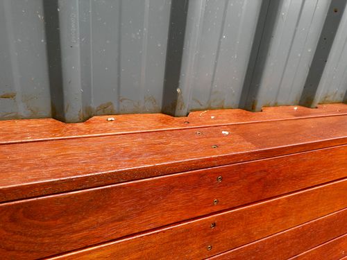

I recently varnished our new bench seat but didn’t realise it would be so hard to remove the excess varnish splashed onto our colorbond fence. I tried metho and some make up removal pads but it wasn’t too successful.
Any ideas?

ok, I gave it a second shot with metho and soaked it. This was effective. Needed a fair bit of elbow grease, however glad it removed the excess.
thanks for your help 🙂
