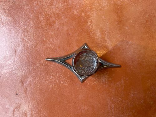

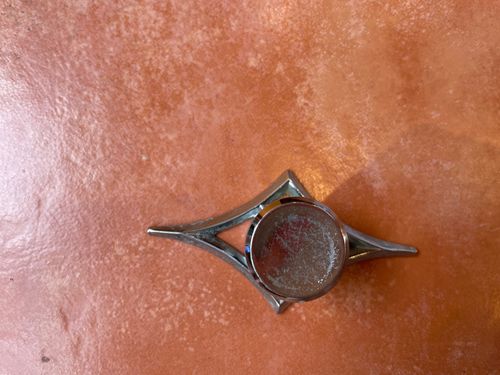

I am restoring a mid century vanity and I would love some suggestions on how to bring back the shine and a cleaner metallic look to the starburst handles and metallic legs.

The handles look like they may be wrought iron. If you have a magnet handy, this will help confirm this.
If they are iron as I suspect, wet sanding with a very fine grit sandpaper such as this 1200 Grit Wet And Dry Sandpaper Roll will remove the dullness but should be done very sparingly to avoid removing more than the smallest amount of the metal. You can then use Autosol Shine Chrome And Metal Polish with a microfibre cloth to really bring out the shine.
