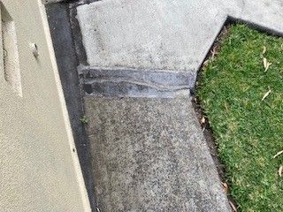

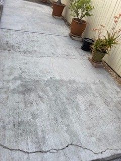

I have been trying to add photos of this problem but couldn't do it....I must be doing something wrong. Sorry Team

Can you describe the crack that you're dealing with?
Is it a wide and deep crack like in How to fill a joint in a concrete slab?
Or a narrow one like in How to repair cracked concrete driveway?
Either way, there is a product and method that should work for you.
I'd be happy to assist further once we have a few more details.
Start by scraping out any debris from the crack in your driveway, making sure to remove any loose or crumbling concrete for a clean surface. Once it’s thoroughly cleaned, fill the crack with Earl's 1kg Concremate Expanding Cement, which locks into place as it cures, creating a strong, lasting bond. For the best results, dampen the crack slightly before applying the Concremate, as a bit of moisture will help it adhere better. Once it sets, you can lightly sand it smooth for a more even finish.
Regularly sealing or even painting the driveway will also help prevent new cracks from forming.
