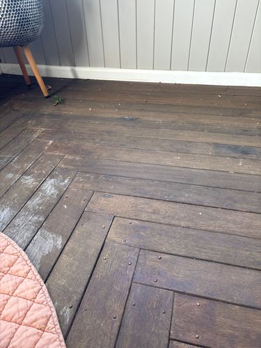

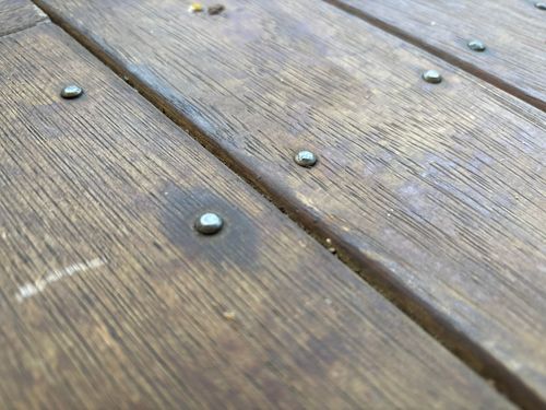

My front deck has what appear to be dome head ring shank nails - they sit above the timber and can’t be punched down. I would love to sand and oil the deck but I am a bit at a loss of how to work around this. Any advice would be appreciated.

Generally, I would suggest using a floor sander to strip the surface of your deck. But because of the dome head nails this is not possible as the sandpaper will get snagged onto the head of the nail and tear itself apart. It's still possible to sand the surface of your deck, but it will take a little bit more time and effort. I propose a two-person sanding team, one person will be using a belt sander to do all the wide spaces between the nails, the other person will be using a detail sander and sanding around the nail heads. If it is done section by section, it will not seem so daunting.
