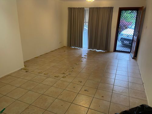

Hi, what can i use to remove old underlay stuck on with adhesive on tiles?
Hi @davetomfish,
Start by using a QEP 4" Floor And Wall Razor Scraper to attempt the removal. With a bit of force, you should be able to remove a lot of the material. Remember to wear gloves and a long-sleeved shirt as the scraper has a sharp edge that can cause lacerations.
If you are struggling with just the scraper, apply some Tricleanium Adhesive Remover to the tufts, allow it to sit for a minute or two then try the scraper again.
